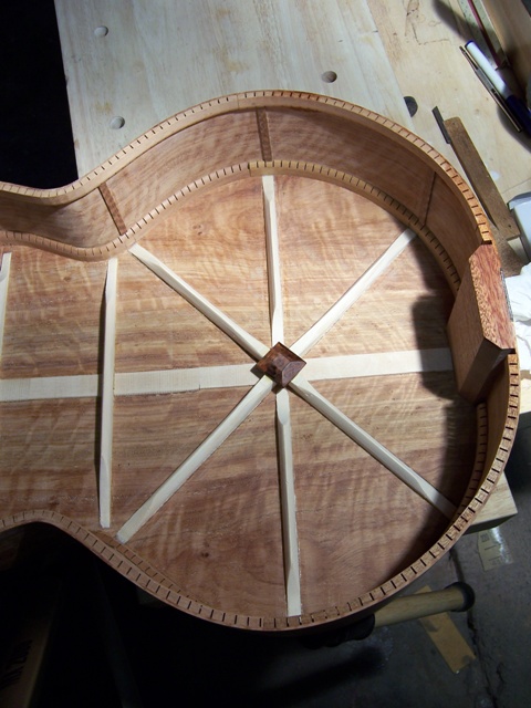

I told you last night that I would post a pic of the change to the OLF SJ back X bracing here it is. This helps support the dome on the 15 1/2" lower bout's edges better. The fingers perpendicular to the apex of the lower bout are 5/16"-3/8" wide x 5/8" tall. The X is now 90 degree intersection.
