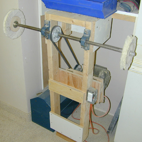

Bigger motor ??? I have a 1/5 on mine, and it DOESNT slow down. Why would you need a bigger one - it wont turn any faster - its 1725 after all ????
here it is - cost - 20 bucks without the buffs, and I traded a guy a homemade fretbender for those !!! If you wanted to do the belt slip thing, its easy with this kind of hinged motor setup - simply wedge the motor up until the belt gets a tad loose. But like Mario says,. if you present the right way, nothing ever gets tossed. Hasnt happened to me (crossing fingers, toes ... knocking on brazrw)

I run 14" wheels at 800rpm for fine compound and 1100rpm for extra fine. As Hesh said I set my belt tention to slip if I try to dog the wheel. A good buff takes really very little pressure. by allowing the belt to slip if you put too much pressure on the wheel you help keep burn throughs down.

Tony, it's hard to believe that's just a 1/5 hp. Nice looking buffer. I guess I based my motor requirements on the real motor buffers by Baldor that I saw Charlie Hoffman using.
Frank Ford has one too I believe and those are 3/4 direct drive motors. Which is different than belt driven shafts somewhat. All that said, I'm very happy with my 1HP 110 V. unit. I do have 12 inch buffs and wide, so maybe it takes more power if you have wider and bigger buffs?
