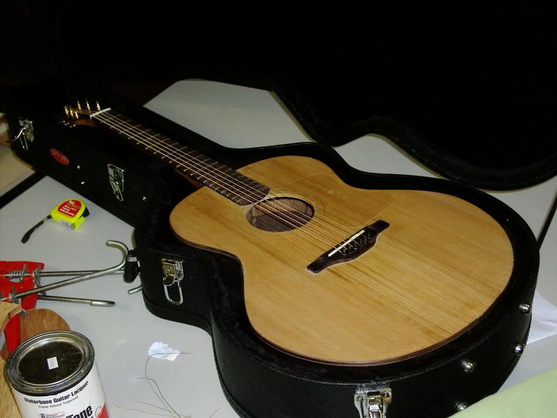

Ok gang this is the evening class guitar, just strung up today.
This has taken over a year at the weekly clas tutored by Sam Irwin, one of George Lowden's original 4 employees from WAAAAY back!!!
Cedar top, East Indian Rosewood back & sides, binding faceplate fingerboard & bridge.
Mahogany EIR lam neck.
Gotoh tuners
Bone nut & saddle
horn pins
I have a piezo under the saddle to run to an external preamp
problems?

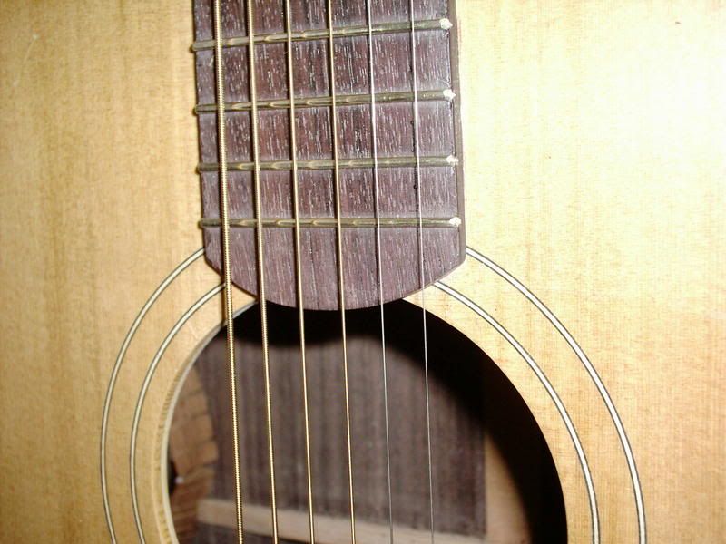

well the finish is 99% and the nut will need re done as the strings are too near the edges of the fingerboard, so I'll cut another with slightly more room at the edges.
a wee strum here.......

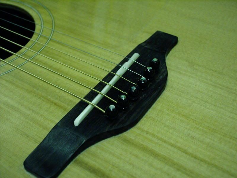

Martin, great job. I looked at the compensated saddle and you had me scratching my head. I would think that B string would need to be opposite, but then that's my pea brain looking at your cool guitar. Thanks for sharing it. I know you are really proud of it.

AHHHHHHHHHHH
you're right!!!!!
Aw man, at least I now have a left handed saddle for farther down the line!!!!
Aw what a muppet!!
I'll now go and sit in a corner facing the wall!!!

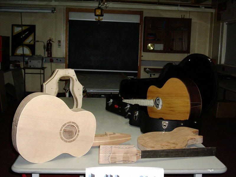

As well as that I have a Les Paul and a Granadillo/cedar mini jumbo under way.......
this was a week ago......

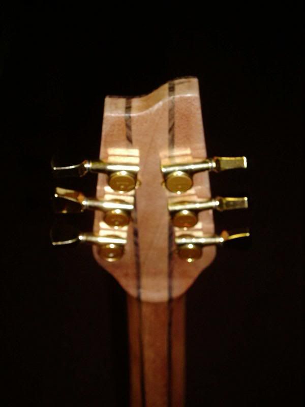

Digging that headstock shape, Martin. A great development on previous designs.

Well, I've just re cut the nut, replaced the errant saddle, oiled the fingerboard & stuck in a label.

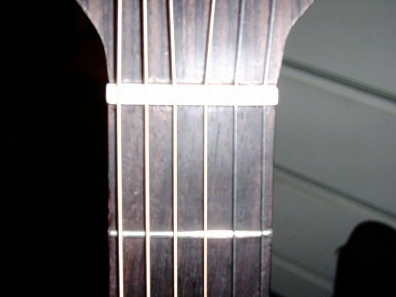

So, no Truss Rod Cover to put my celtic cross on so it found it's way onto the label
The nut is now a better width, with the High E not falling off the edge of the neck
and the saddle is now compensated to IMPROVE intonation
