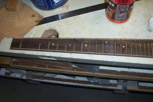

Last serie of pics guys, for now that is!
Cheap insurance
Brother Martin visiting, he will be my next victim!
Thanks again for watching!

Sweet!!!!! Love the fingerboard and have always been a big fan of ash. It's
going to look BEAUTIFUL finshed.

Looks beautiful!!

Very nice Serge!
I agree, the fingerboard looks great!

Serge,

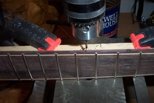

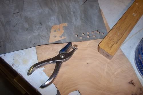

What are you making the fingerboard dots from? Looks very cool!

Great looking guitar. And I like the idea of using a veneer for the fingerboard dots- a lot cheaper than shell inlay, and just as nice looking.

WoW again ,nice fingerboard! I really like this guitar Serge.Your a doin' a great job man!

Thanks fellas!
Wayne, the fingerboard dots were cut from thin veneers that i bought at Lee Valley, a lifetime supply for $50 Can, easy to pierce with that paper piercing tool that i forget the name!
Thanks Hesh! Yeah, Martin has his ways of knowing things in advance, he found out about my plans!
Thanks Gene, oh and i forgot, the colleection of veneers in the box that Lee Valley sells has tremendous variety!

Serge, oh my have you done well! What finish are you going to use? Love that ash! Bet you are getting excited to finish and hear it.
Clinton
PostPosted: Thu Feb 01, 2007 2:52 pm
Thanks Clinton, i will try varnish for the back and sides and maybe FP for the top.
You bet i can't wait, this is the lightest guitar i've held in my hands me thinks!

Nice job Serge. Looking forward to completion. Small jumbo yeah?

Thanks Larry, yes, the OLF SJ as per Michael Payne's plans, really detailed and precise, love that shape.

Thanks Terry, the fretboard design was inspired by Kevin Gallagher actually but it was a pain to bend the laminations in there though, Kevin has skills that i don't have yet especially with inlaying.

thats a beaut. Serge,Always a pleasure seeing your progress pics my friend.That veneer thing is way cool i'll have to check my local wood craft for veneer now.

Thanks Tim, one other nice things about the Lee Valley veneers was that i used some as side braces and i also plan on using 3 layers of them to make a wooden pickguard, i think it should give the guitar some artsy feeling.
Oh and i will also try to come up with my own logo, using them veneers!
