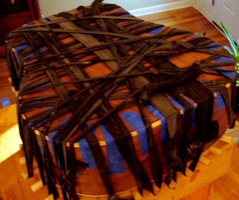

This is how I do it...just old inner tubes cut into strips that are not too strong. I built a simple jig to wrap the bands around, I like this much better than tape....for me it works great.

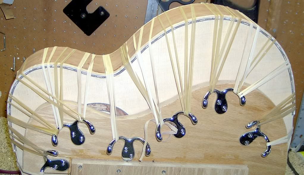

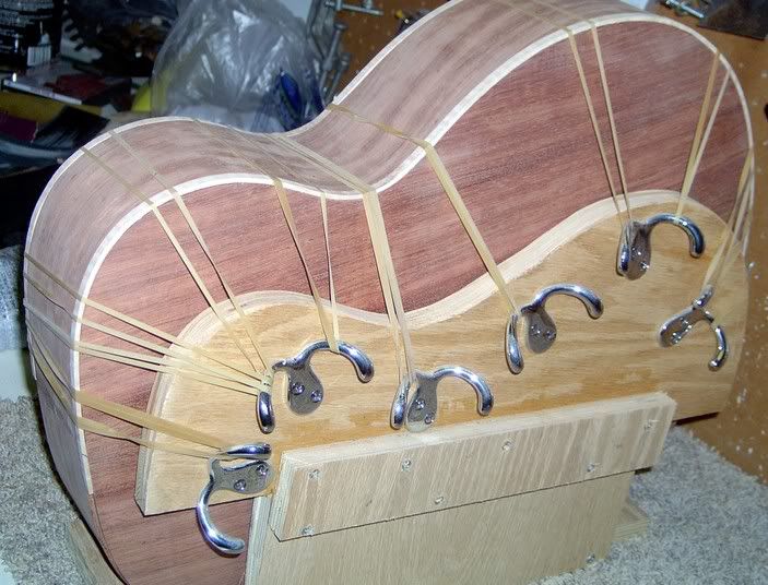

I use brown LMI tape and clamps as needed.
I saw a picture of a fixture that is used at the Goodall factory and copied it. I use it for several guitars. It works well, but I like tape better.
If you want this one, I'll send it to you if you pay for packing and shipping, probably about $25 -$30.
I had to get creative on cutaways.
