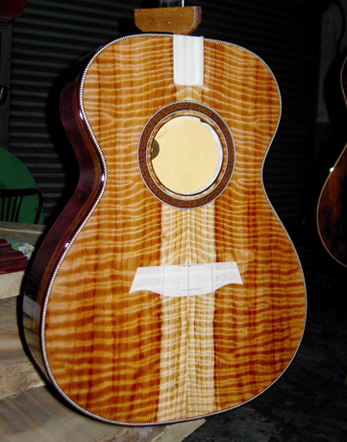

James here's one I built about 5 years ago. No signs of cracking yet. I'd have to check my notes but is somewhere about .125 -.130

Very pretty Bob - two things my friend.
First:  Any plans to start building again?
And second:  How did you get the ebony bridge so very black.  I love the look - inquiring minds want to know please?
PostPosted: Sat Nov 03, 2007 2:03 pm
Hesh building again is always on my mind. I guess I just have to make some time. As far as the bridge it;'s just a piece of black ebony buffed out.
