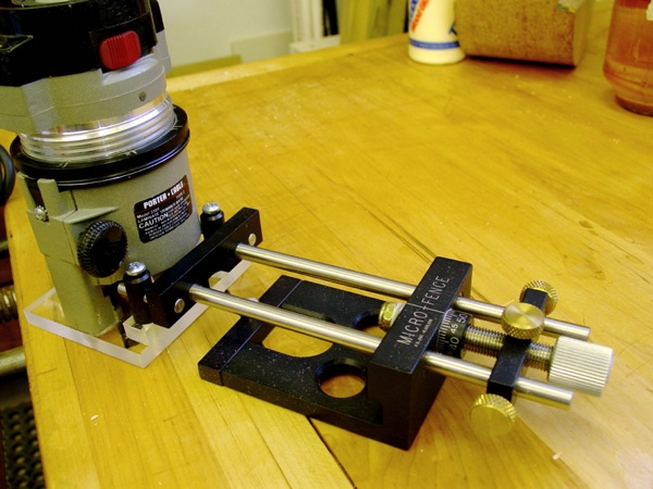

The micro fence attachment for the PC 310 will work however it sets the
router in the air a 1/4" or so off the top. Probably fine until you try to use
1/16" bits and I believe they will break in a heartbeat. I made a new base for
the PC 310 that accepts the micro jig and keeps the 310 on the ground and
usable with 1/16" bits. I thought I had posted a photo before but I'll try to
find a photo again and post it for everyone. It is the absolute Rolls Royce of
circle cutters for guitars for the reasons Paul spoke of earlier.
Sylvan
http://www.wellsguitars.com
PostPosted: Mon Feb 20, 2006 9:24 am
Posts: 389
Here is the photo.
Sylvan38768.7275694444
