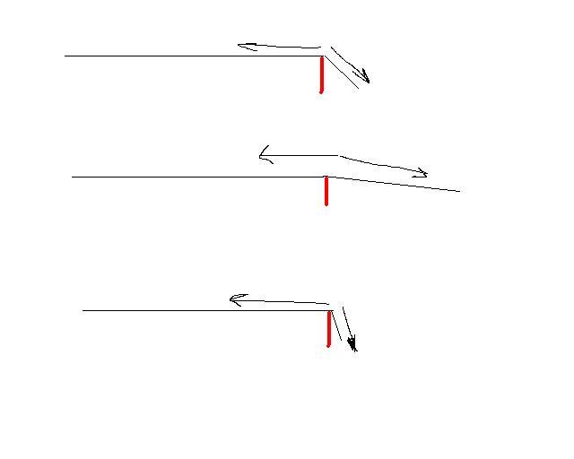

Todd, I will have to disagree with you.
Take a look at this
As you can see, there are forces pulling at the saddle in all three senarios.
The first, (optimal for guitars, I think) transfers the force at "equal" amount down to the saddle and out toward the back of the guitar, thus the torque on the top is also equal as there is pull from the back of the string and push on the saddle.
The second exerts a lot less force down on the saddle. Most of the force is applied back where the strings end (some where in the middle of the lower bout or at the tail I guess), since there is not as much downward force on the saddle, the torque on the top is less.
The third exerts most of the force down on the saddle, so now the reacting force pulls the top up hard and the torque under the saddle will be very high.
There is as Kevin has stated alot to consider with such a force on such a small area. Now if the bridge were say 4" x 8" (very large right) than what you have done is esentially made that top that much thicker for a larger footprint, and the torque would be less (the strength of the top is relivant to the thickness and stiffness). If the bridge were 1"x3" (very small) the torque on the top would also be more as the surface area is less.
Now a taller bridge will made the top that much more stiff in the bridge area, less torque seen by the top as it is effectivly stronger. But a taller saddle on a lower bridge with have to opposite effect.
The top will experience the torque differently as the strenght of the top (thickness, stiffness) goes up and down.
I'm sure that I havn't explained this very well, but I hope you see that there will be a difference in torque based on the angle of the downward force exerted by the string on the saddle.Rod True38870.5603935185
PostPosted: Fri Jun 02, 2006 4:22 am
Posts: 1059
Todd,
I'm not an engineer either. But it's actually a rather basic calculation that a 1st year physics text will have examples of. The greater the "break angle, the more force is projected downward both at the saddle and at the terminal point on the bridge.

It may be just the limits of my brain or of my level of comprehension of physics and trigonometry, but I am still seeing it the way Paul is. I see that the way the force is acting on the saddle and saddle slot (both the front wall and the floor of the slot) will vary a great deal depending on saddle height and saddle back-tilt, but I don't see how the total torqueing force on the bridge area could be different if the total height of the strings off the top is the same.
Let's suppose that instead of a saddle we had a low bar fixed to the bridge that the strings passed UNDER (think some sort of wide staple). Then, instead of the strings going down into bridge pin holes, they went UP and were tied to tall screw eyes screwed down into the back part of the bridge. (Again the height of the strings off the top is the same.) Have we then reversed the torque on the top? No. Have we changed it at all? I don't see how. But, like I said, maybe it's just that my brain, like the Grinch's heart, is two sizes too small.
Todd Rose
Ithaca, NY
PostPosted: Fri Jun 02, 2006 11:59 pm
I thought about this alot last night about how to explain it - I see where Paul and Todd are coming from, thinking that if the string height is 1/2 inch, no matter what the bridge saddle config is, then the torque is the same. But, do you agree that the down pressure on the saddle changes with break angle, given the string height stays the same ??? Then the torques has to change also. Why is that - because the force on the saddle is not directly down on the top - for that to be true the string would have to break down at the top at the same angle it approaches the saddle. But it doesnt do that ever. The string creates forces on the saddle as shown way back in those force vector drawings. The greater the angle the more force you get on the saddle. Rotational torque is a function of force and distance from the rotational centre, which is essentially the physical centre of the bridge. If you move the force away from the centre, the same force produces more torque - think of a wrench or socket drive - same force further away creates more torque. So, by increasing the break angle, we create more force on the saddle which is closer to the leading edge of the bridge, and thus the rotational torque will have to increase.
Paul mentioned that there are two torques, one of the saddle trying to break the slot, the other on the top - well if the saddle slot doesnt break, than that force is being applied to the top - it has to go somewhere.
There are actually two torques applied - one where the string breaks off the bridge pin hole, the other at the saddle. The two forces (not torques) may be the same total for two different saddle/bridge configs (again assuming the string height stays constant), but the position and value of each force can change, and since they occur at different distances form the rotational centre, the torque applied will be different in each case.
Todd - lets take your example of the staple type saddle with some sort of eye bolts holding the ball ends. You are correct, the torque has not reversed - why - because the direction of pull is still the same about the centre of rotation, and thus the direction of rotational torque is the same. Now want to change the torque value WITHOUT changing the tension or saddle config - thats too easy - make the eye bolts longer and the torque will go up - its a simple lever at at work - same force, longer distance - if this werent true longer wrenches wouldnt work at all.
The bottom line in my mind is if you beleive that the downforce on the saddle can be changed by changing break angle, then the torque has to change with it - you are moving the position of the force, and torque is forcexdistance.
