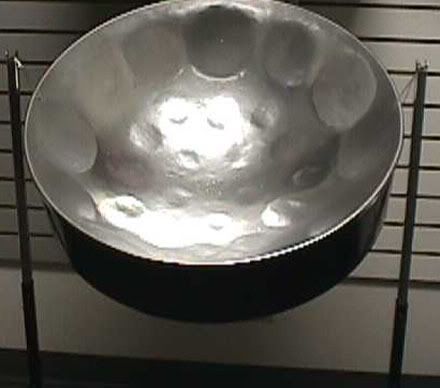

Since what happens on a guitar top is so difficult to actually see.   I go back to a couple of visual examples that keep sticking in my mind.
There was this experiment in my high school physics class that had a shallow pan of water about 2' in diameter. Attached to the side were a couple of vibrating gizmos, basically a small ball on the end of a stick, that were placed on the surface of the water. You could vary the frequency of the vibrations and you could also move the vibrators to different places on the pan. It was interesting to see the different wave patterns you could get. You could see how waves reflected off the sides and how they reacted with each other. Sometimes cancelling each other and other times reinforcing each other depending upon frequency and position. You could also get patterns that look like Chladni patterns, where small "peaks" of water would shoot straight up. I think a guitar top is very much like this, but the oscillations are much smaller and faster.
Another example is the caribean steel pan drum, like this one.
It must have taken alot of experimenting to figure out the size and placement of the "bumps" to get different notes all out of one piece of steel. But there is a pattern.
What I get out of this is that for every surface that vibrates, there are adjacent node points. And on the other side of the node is another surface vibrating opposite the first surface. Just like the first harmonic on a guitar string, the two halves of the string are oscillating in opposite directions with the node in between.
Sorry for being long winded, but I'm fascinated by this and I'd like to hear more of what others have to say.
Ok I'll shut up now.
