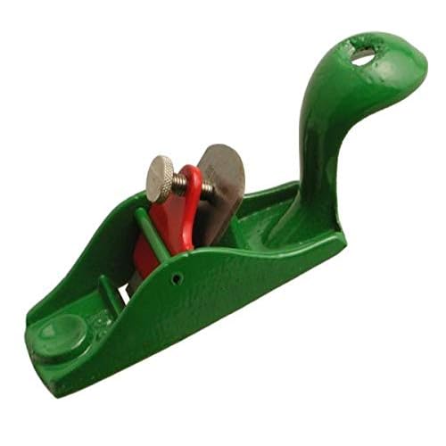

I recently got a little Kunz 100 squirrel tailed Pocket Plane for carving braces and other small tasks. I like that it has the raised tail as I have large hands, and it's difficult for me to use those tiny Ibex finger planes. This thread has got me thinking about getting another Kunz and grinding a radius into the sole. What is a good radius to use? Anyone else tried radiusing a flat soled metal plane?

I recently bought the Lee Niesen version of that plane. Much more costly but well worth the money. I`m going to buy the convex sole version of the tool as well for doing archtops.

Thanks for that! The Nielsen site had the info I was looking for regarding radius. I may wind up buying the Nielsen convex too, but want to try fetteling(sp?) the Kunz 1st as it's only $18. I recently bought the Nielsen 60 1/2 Low Angle block, and now I know what everyone's talking about. Nielsen planes are the Porsche, Rolex's of the hand plane world. I'm just blown away at the quality and precision. It's fun though to have a go at hand making or modifying tools. Those Woodsmith plane kits off eBay are a super bargin with the Hock blades, I've bought 2 block and 1 chisel plane kits for a little more than the price of 1 blade directly from the Hock site.

Yes. Richard Schneider cut off some of the toe and heel of a Kunz, and put a longitudinal radius on it. I believe he also thinned the sides. LMI sells a bronze version of the Schneider plane. Check it out.

The Kunz doesn't have a real thick sole to allow much radiusing.
Has anybody managed to bond an extra layer (of wood? brass?) to the sole to give more 'meat' for curving the base?

Now that's another great idea!! Bonding a layer of wood to the metal sole sounds like a good plan. I think I'll try it. This thread is giving me some good info.

Regarding the Kunz, remember that an objective is to have a more narrow throat for fine cuts than is presently possible with the stock tool.
I agree there is not enough metal on the original plane to radius the sole, but the real problem is that there will never be a tighter throat. So you will have to put some material on the sole if you want to make fine cuts. Wood plane restorers often glue a layer of wood onto the sole of a worn plane to tighten up the throat. I have not heard of anyone doing this with a metal plane, but perhaps you could shim the bed or get a thicker blade to move the blade edge closer to the front of the opening.
