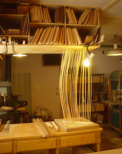

PostPosted: Fri Sep 21, 2007 2:02 pm
Posts: 332
This is my setup....
The photo pretty much tells the story.
I agree with Al Carruth about lots of long, soft, bars being better than a few stiff ones. My bars are 42" long. They are pine, .275" square.
Mark
