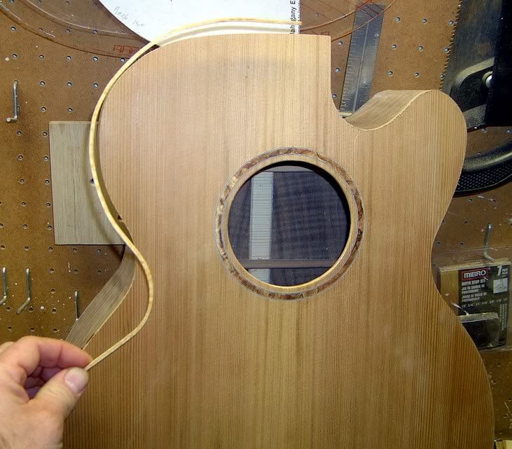

Steve, that is awesome. I really love the thick maple purfling. How deep is it?
PostPosted: Wed May 31, 2006 5:16 pm
Posts: 1969
[QUOTE=SniderMike] Steve, that is awesome. I really love the thick maple purfling. How deep is it?
Mike[/QUOTE] It's about .050" thick.

[QUOTE=SteveS] [QUOTE=SniderMike] Steve, that is awesome. I really love the thick maple purfling. How deep is it?
Mike[/QUOTE] It's about .050" thick.[/QUOTE]
Wow. How the hell did you bend it and keep it flat and not break it? Very impressive. I'd love to know.

Mike,
I might have broken a few pieces before I was done.
You can probably tell from the picture below.
It is about .125" wide.
I think it would be pretty much impossible to bend figured maple that is .125" wide and .050" thick.
So I made it .125" wide and .125" thick. (I made a few extra pieces because I knew I'd need them.)
Then I bent them by hand, glued them in place and sanded of the extra .075".

[QUOTE=SteveS] Mike,
Thanks Steve. That's brilliant! It looks amazing.
