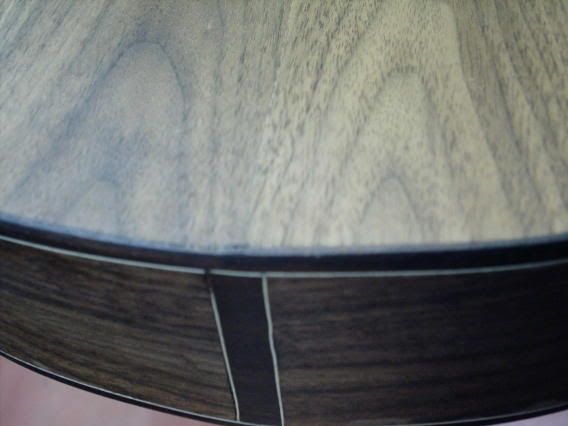

My latest attempt I cut the binding to length then steamed it with the wallpaper stripper till it was REALLY floppy. Then I towelled it dry(ISH) and stuck it (with 2" masking tape) as I bent it round the binding channel (cut with my new SM binding cutter!!). This was FAR more successful even though I stuck in a little maple purfling strip too.....
while it's nowhere near some of your work folks, I'm really pleased with this second attempt at binding. Walnut salvaged from a dumpster BTW!!!
