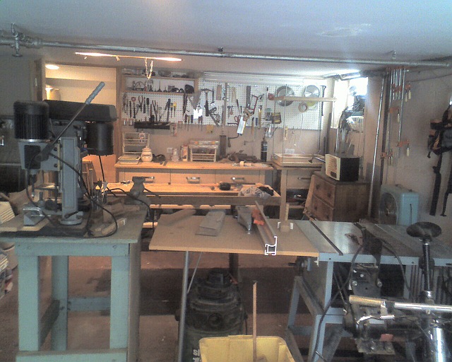

MichaelP and all: Thanks for all of the excellent suggestions. I have done some mods and now have 1.5" on the top and bottom panels and lowered the overall height. The inside material is ply so the glass rods should have sufficient purchase on the surfaces of the ply. If, as you say, Michael, the 3/8" all-thread is too wimpy, I will just have to drill out the holes and upgrade that. I like your idea of leaving some rod exposed to permit adjustment of the top to the operation being done. The rod covering must wait for next weekend, I am afraid.
Fortunately, even building this thing twice, it will be less expensive than buying one! I just reorganized my shop. Here is a piccy for y'all.
PostPosted: Tue Sep 05, 2006 5:00 am
Nice looking shop there Steve. Can't wait to see some more progress piccy's.
