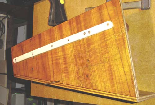

Well, inspired by Michaels advise, and because I love hanging stuff on the wall because it makes me look like I know what I am doing, I went ahead and built me one of them scarf cutting jigs....
Too easy! The most time consuming part was shaping a handle from scrap Jarrah. I just used what was at hand, I had some 1/2" marine ply with a nice teak veneer laying around so that choice was made. The glue blocks supporting the fence came from the same piece as the handle was fashioned from and were left larger than needed to compensate for the thickness downsize of the ply.
The sled runner was fashioned from an old cutting board (which mysteriously disappeared from the kitchen quite a while ago) a quick coat of shellac and she is ready to hang on the wall

well kim, by now you should have a couple of scarf joints cut, glued and cleaned up! let's have an after action report on your jig?
PostPosted: Sun Dec 10, 2006 12:55 pm
What! Take the jig back down from the wall?? Surely you jest??? Make dust in my shop!!! No, No, No! For goodness sake man get a grip! Kolonel Kragenbrink of the Klean Korps would simply not hear of it (Sorry Lance)
Michael, I will post picks when the new blade arrives, the 9 1/4" mounted on the old Gilbro saw will just not cut it so to speak.
