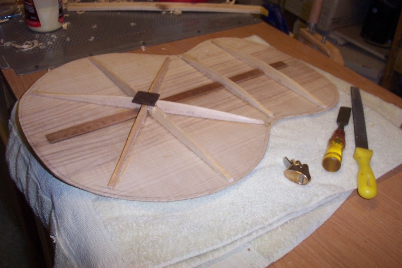

This discussion intrigues me because I have had the similar thoughts to LarryH. The compound bend doesn't have me stymied, but all(?) pictures i have seen for the backs, the underside of the braces (that is glued to the back) is never radiused, so i imagine when using the go-bar deck that the braces are forced down into the curve of the dish. To me, that means that the braces are spring loaded and the only thing stopping them from popping off is the hide glue. I don't know what the forces are but it seems like something one would not want to do. Have i missed the pictures of people shaving the braces before they are glued on? Or perhaps the tension acts to load the back tension and make it more responsive? (or maybe it just doesn't make a dang of difference?)
Also, if it is a compound curve, are the braces tilted a bit (towards the imginary center of the 25' circle) to compensate for the curve or is there a little glue filled gap?
Lastly, the picture above (to me) seems that the braces are a bit beefy. This discussion seems to imply that those braces mainly prevent the back from splitting, aren't they overly large for that? I see bias tape used for the sides for the same purpose. (I know, i have to go read some of the books first, and i do plan to. Just that this discussion caught my eye.)
Obviously the backs take some banging, but i imagine the stresses are nowhere near those that the top endures due to the string tension... or am i waaaay off? They just seem to be overly designed. (and not just this pic but all guitars). What are the stresses the back braces are designed for?

PostPosted: Wed Dec 27, 2006 11:16 am
rob, there is a school of thought that favors forcing a straight brace and the plate into the dish or curved gluing caul and relies on glue to hold the curvature.
far more common is the radiusing of the brace to match the final radius of the plate and only the plate is bent into the radiused shape, into the dish and around the brace. and one should be trying to ensure that there are no voids to be filled with glue.
as to your comments regarding the bracing of the back above, to me it is overly heavy as well. better builders are well known to try to minimize their bracing, particularly of tops, to increase responsiveness. overbracing is something which factories and inexperienced builders are prone to.

PostPosted: Wed Dec 27, 2006 1:44 pm

I have another question about various bracing schemes like one shown I used on my second Martin Jumbo kit.
I just have this intuitive feeling about the fan type bracing and will probably use it again but I see no way to preserve any kind of radius with the braces aligned as shown. The guitar is not dead flat but I don't know how the radius got there.
Is the 'X' enough to preserve a radius when using bracing other than 'tone bars' (of which I do not understand to this day) which seem like they would help immensely?

PostPosted: Wed Dec 27, 2006 3:30 pm
your two A braces if radiused would help preserve the top radius. most schemes i've seen akin to this use a transverse brace between the x at the back of the brdge plate. the profiled rim will also help retain the dome.
PostPosted: Thu Dec 28, 2006 12:10 am
If your upper braces are radiused, they will certainly preserve the radius up there. Even if the lower X and the fans are not, you will still get a radius in the back over time - why - string pull will do it for you. Pretty much all the true disciples of Larrivee use top braces whcih are radiused from the X intersection forward to the neck, and flat to the back. Larrivee's reasoning is that the top wants to cave in front of the bridge, so the radius up there either keeps it radiused, or flat at worst, and the flat behind the bridge will pull up with tension anyway.
