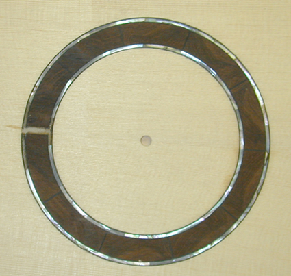

If I wanted to do a rosette like the one in the picture below, would I have to cut my own abalone? I have cut my own abalone curved strips for a single rosette circle many times, but it is very time consuming. Lately I've been buying my curved rosette pieces pre-cut. I just don't know of anywhere that sells them with a different inner radius. Anybody got any ideas?

Hi Colby, that's a nice rosette. Is it one of yours or just an example of what you plan?

yes anthony, that's them.

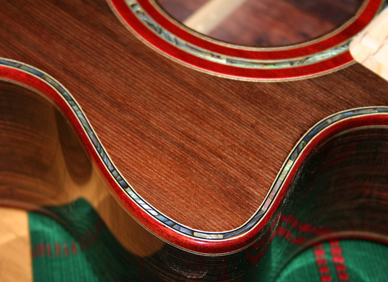

Yes ablam breaks a bit better than natural shell. Every guitar that has body shell purfling must have the waist area broke from ablam or shell into a tighter radius that the shell came with unless custom cut.
If you don't have to sand much ablam works great for rosettes and top purfling. but if you have to sand you can some times get part of one layer showing through the top layer and it can look a bit funny.

I do all my abalone purflings from real shell and have no problem breaking them into tight curves.

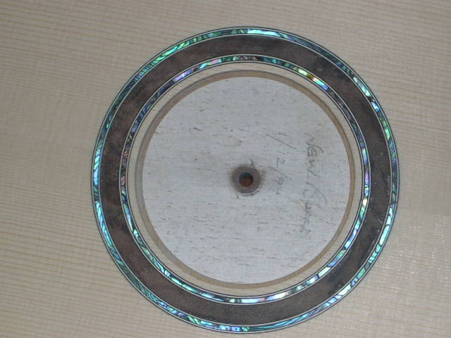

Std rosette radius shell will work fine - I did this one with .063 curved red ab from MOPsupplies, same radius inner and outer ring .. it just snaps in. Wood is braz rw bookmatch segmented. Soundhole will be 4 inch.
PostPosted: Wed Dec 27, 2006 6:19 pm
Thanks Tony! Nice rosette!
Colby -- perhaps this thread is too dated for you to respond but is that a picture of a Kinnaird Rosette? Anthony Z39079.0981365741
