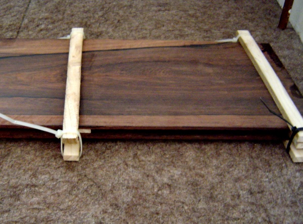

Two methods to consider:
If they are dished, lightly dampen the concave side and lay them on a concrete floor concave side down and place a weight on top. It rarely takes more than overnight for them to flatten.
If they are more stubborn get nine stickers, (strips of wood) three the width of the backs and six a couple of inches longer.   Make layer of long stickers, back, short stickers, back, long stickers, have the two concave faces on the outside. Then place a cable tie over each pair of the longer stickers and tighten, lightly spritz the outside concave faces. As the wood flattens gradually tighten the cable ties. Leave them for a couple of weeks to really set flat.
You stack should look like this ( except not in Mad Rose!)
ColinColin S39078.7453935185
