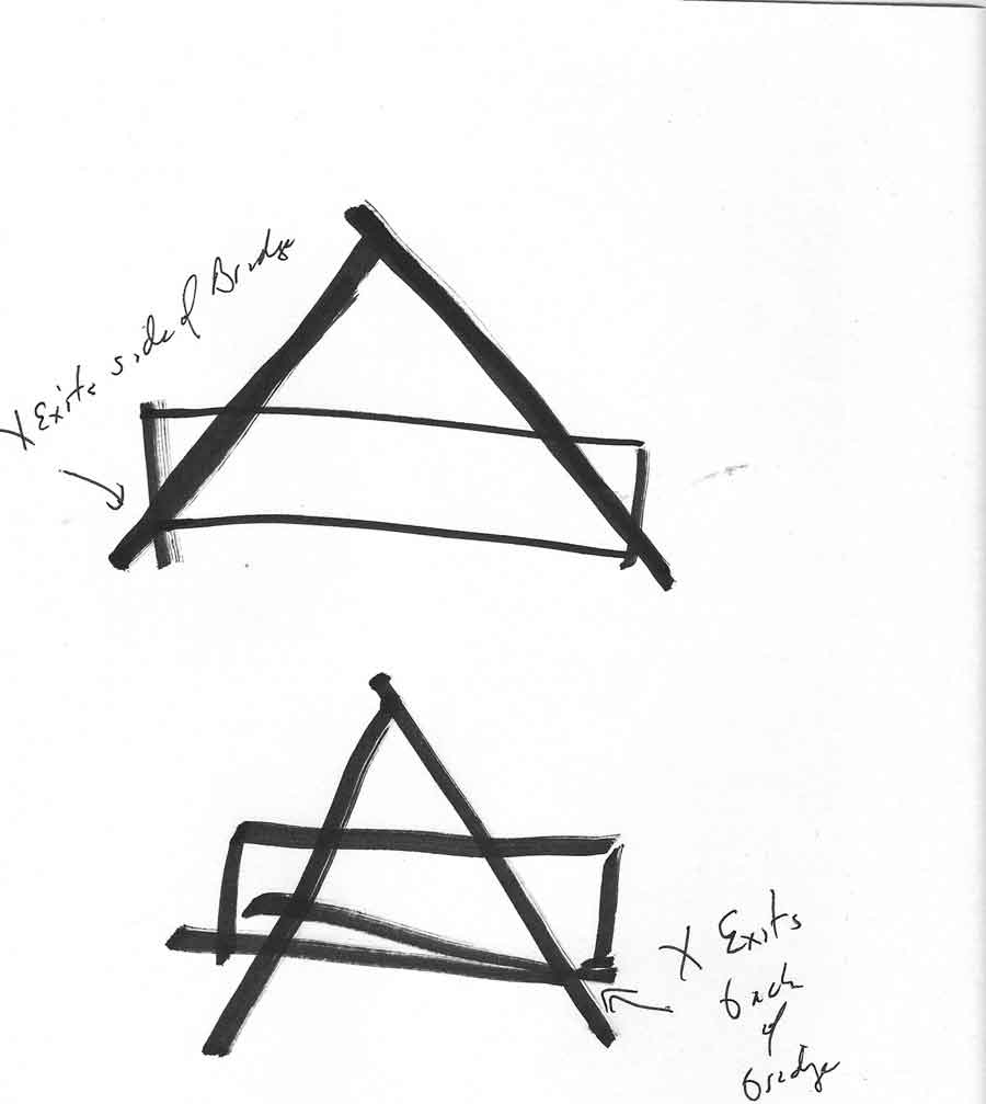

PostPosted: Fri Dec 29, 2006 11:23 am
When you say the X braces need to support the bridge, I am bit confused.
As the X braces span out and cross over the headstock side of the bridge,
can they exit out the sides of the bridge or should they exit out the back
(tailblock) side of the bridge?
Make sense.
I have had mine so they exit out the side of the bridge at the back corner
towards the tailblock.

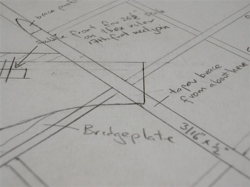

Ask Dave White this question and He'll tell you what he uses. Every picture I've seen of his shows his x-brace angle below 90*
I stole this off your site Dave, hope that's ok
PostPosted: Fri Dec 29, 2006 11:34 am
[QUOTE=Rod True] Ask Dave White this question and He'll tell you what he uses. Every picture I've seen of his shows his x-brace angle below 90*
No problem Rod.
I use an angle of about 75-78°. I have my top in quite a big arch though (the braces are shaped to 13' radius) and so I figure I don't need as much lateral stifness from the X braces. It usually works out that the 1st and 6th strings on the saddle correspond pretty closely to where the X brace arms are. I settled on this design after looking at a lot of Stefan Sobell's guitars - a maker for whose work and sound I have enormous respect.

[QUOTE=azimmer1] When you say the X braces need to support the bridge, I am bit confused.
Make sense.
towards the tailblock.[/QUOTE]
No, I don't really understand your question, but I think we are on the same page. All I meant was that your bridge needs to set firmly over the legs of the x brace.

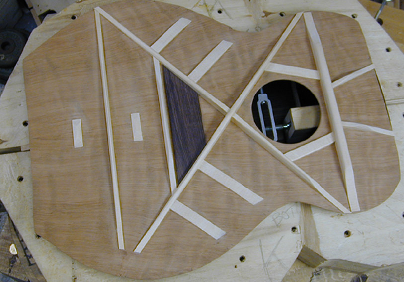

Almost all of mine are designed to come out the side edge, closer to the front corner than Tracy has in his bracing drawing up higher in the thread. My X angle is 98 degrees on everything except baritones (90) and multiscales, which are completely assymetrical, and each one different depending on the scales and the straight fret placement. I use a trapezoidal bridge plae shape, and like Larrivee's have a transverse brace abotu 1/4 inch behind the back of that. On my 13 fretters (or anything new for that matter), the bracing layout is designed from scratch, depending on the scale, fret joint and soundhole size.
Here are the innards of a recently completed curly redwood topped 15.5 inch Siganture body. The bass side braces are cut short (the lower X and transverse that dont meet) to be let into the guitars armrest block. Because fo the softer redwood, I opted for wider fingers on this one, they are about 3/4 by 1/8 high spruce. I have also stopped using the big popsicle brace altogether, and now use the two neck block side braces as shown. The patch is EI rw, actually made from back cutoffs from the Larrivee factory !!! Local shop had a huge box of them one day, 20 for 5 bucks, I have about a ten year supply - nicely thicknessed and ready to trim up - beauty eh !!!
