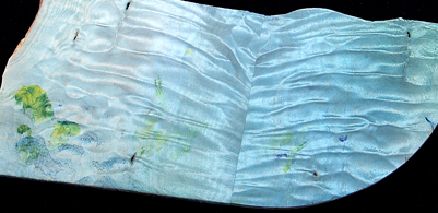

Anyway, I think I'm getting pretty comfortable with the coloring. Here's
some scrap, if anyone is interested:
Thanks for everyone's help.
