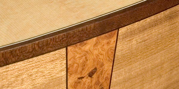

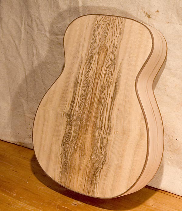

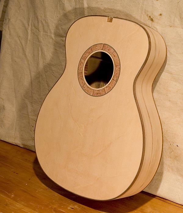

Found a bit of time during the holidays to glue up the sound box and install the bindings (Myrtle b&s with Walnut bindings). I ended up with a couple small gaps at the tight bends at the waist and upper bout but they disappeared with a little glue and sanding dust. Do many of you use clamping cauls in this area when installing the bindings? Given the soreness of my thumbs the next morning, I don’t think I would be able to increase the taping pressure next time.

Thanks for the comments and suggestions. You are correct about the bindings Rod. They came out of the bender with some spring back at the waist area and I don’t have a hot pipe to persuade them into the exact shape. A rubber faced caul the same profile as the waist used with a good amount of caution seems tempting though. Since you would have constant visual feedback of the glue joint, you could slowly squeeze just until the gaps close. In fact the “tools and jigs” section on the site links to “Berna Hobby Clamps (Great for clamping your bindings at the waist)”.    Your caution regarding the danger of over clamping is a valid one however. The other obvious solution as mentioned is to buy/build a hot pipe and solve the problem at the source. Has anyone else used clamping cauls with success or disaster?dmills39079.907025463
