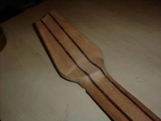

OK folks, I'm in trouble.
The neck in the pics below has had a disaster.
This is the guitar that I'm building at the evening class and it is ready for finishing, neck glues on, fretted etc, BUT the nut on the truss rod has snapped off!!!
Now my first inclination is to finish away and see if it'll survive with light strings on.
IF this doesn't work and the neck starts to bow, I'll need to replace the truss rod. To get it out, the fingerboard will need to come off the guitar. It's stuck on with titebond 2 (the yellow stuff). If I make up a heating block from aluminium with slots for the frets I can heat it with an iron. My big worry is that the rosewood/mahogany neck will separate too......
Am I fearing unneccesarally?
Thanks folks!!
