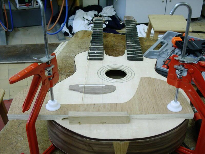

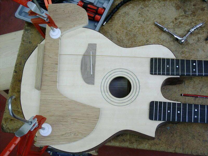

I've built a jig for alligning the bridge on the guitar using a temporary tailpiece. If I'm honest, I'm just not accurate or patient enough when it comes to measuring!!! this lets you fine tune sideways too.....

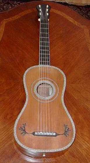

Pinned bridges go 'way back. I worked on an 1844 Panormo with an early form of fan bracing that had a pin bridge. I got to work on it because the fellow who got it out of his grandmother's attic tried putting steel strings on it. The windings caught and chipped the bridge before he got it up to tension, which would have ripped the 1-piece top right off it. Anyway, even earlier ladder-braced tops used pin bridges, too. The Spanish are the only ones who seem to have retained the 'traditional' tie block bridge once the pin bridge came into use. I rather suspect, as I say, that the pins were picked up from the harp, and were used at least in part simply out of fashion at first.
PostPosted: Sat Jan 13, 2007 9:55 am
Couple of years ago I repaired this anonymous 1780s London guitar for the RCM museum that had a pinned bridge, they go back even earlier than that to the 1750s at least.
By the way this is one of the sweetest sounding guitars I've ever played.
