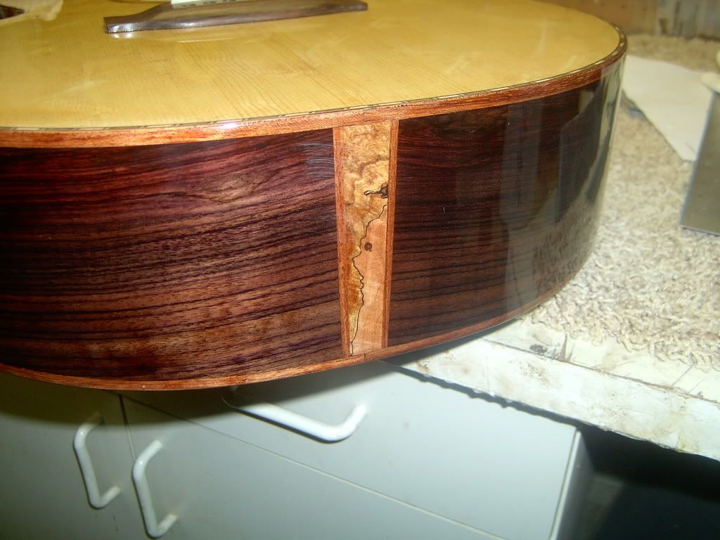

How about some pictures of the guitar?

[QUOTE=Bruce Dickey] How about some pictures of the guitar?[/QUOTE]
I don't have many pictures to post yet. Just this one with some wax that looks like scratches.
Bearclaw sitka on EI rosewood with bubinga bindings and some spalted maple - CrystaLac water based finish.
