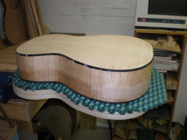

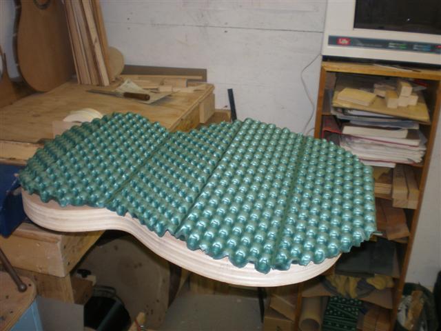

We haven't had an odd tool, jig or fixtures type thread in a while and seeing as we have sooooo many new members here I thought that I would start one.
Back when Kevin G was posting progress pictures of his African guitar (still gives me goose bumps thinking about that great guitar) there was a picture of the body in progress laying on a piece of "corrugated" foam (for lack of a better word).

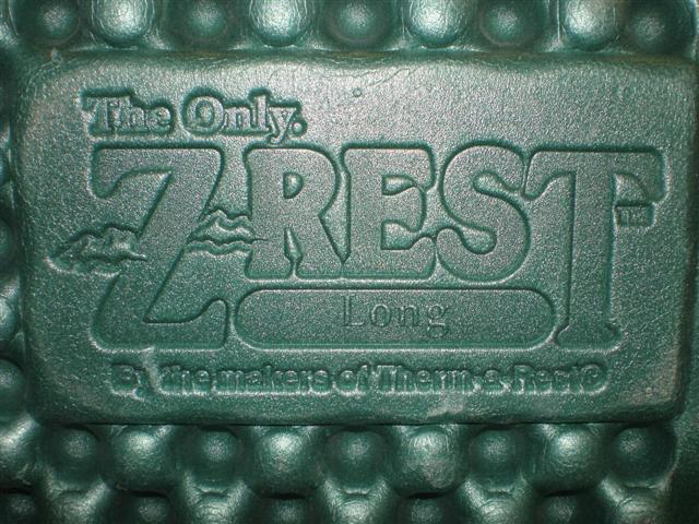

Well, I was at the local MCC the other day and saw this for $4. It's a thurma rest.
And thought, hey that kind of looks like it could be good for a soft protection of the guitar body when sanding and scraping etc...
There are little divots or what have you to catch the dust, chips etc so that they don't aid in scratching the top etc when working on the board.
Anyone else come up with some odd things to use in the shop. I sure like the Serge Sander posted a while back Rod True39088.7431828704

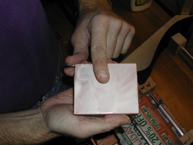

Here is probably the most used tool in my shop. I use it in almost every step while building my guitars. I don't know what I would do without my high tech glue spreading device.

Robbie: I've got a bunch just like that one here, too! Only danger is they sometimes tinge the glue a nice shade if pink if you're using indexing brads and forget to avoid them...

Rod...call me paranoid but I try to avoid those molded rubber or plastic pads for anything around guitars. Having some knowledge about the molding industry, it's quite common to use silicone mold release sprays around those operations. The problem is...it hangs around for a long time and I don't know of any practical way to detect it's presence.
So for me, it's still plush carpeting.

A rubber router pad ruined the lacquer finish on my #3 guitar. It has a nice waffle pattern in the back, and no amount of polishing, sanding, overspraying, or redesolving has been able to fix it.

     I can second what JJ said, I was in the plastic fields for years. Better safe than sorry!

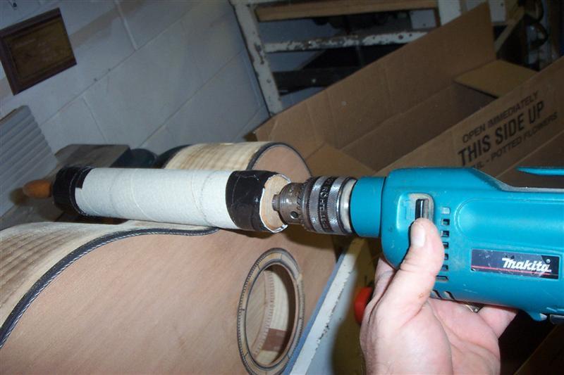

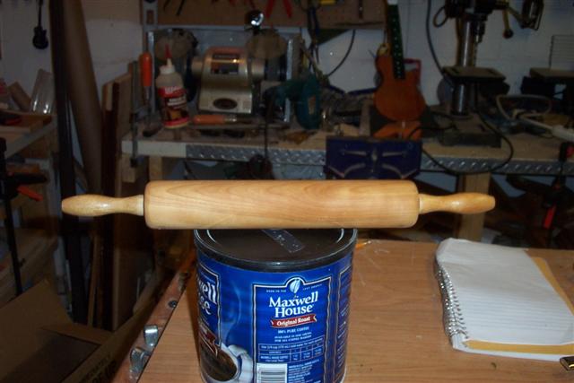

Thanks Rod for liking my Serge Sander, Alain now own's my super power dough roller!

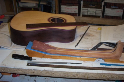

Here's my neck handler made with...well...a kitchen table's leg

Thanks for the tip JJ on the therma rest, I guess I'll just use it for taking a nap seeing as no one else has anything to add to this thread.

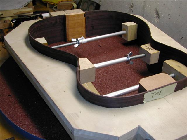

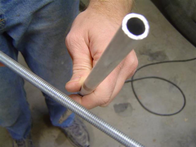

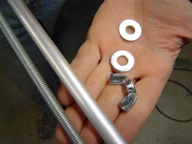

Give us another look (a first look for newer folks) at those "O'Brian Spreaders," if you would. I think they're an ingenious alternative to the usual turnbuckle type.

Here is a shot of the spreaders. Now I want to see everyone spread 'em!! You can make them out of threaded rod and aluminum tubing availabe at your local "luthier supply warehouse"

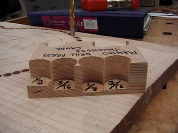

Here's one. I'm sure you can buy something like it for some bucks at the
local luthier supply where(?)house. But, lets say you are teaching a
mandolin building class and you need to demonstrate a plate carving
technique (Bendetto style, as I've heard) using a drill press and need a
hole depth gauge. Well, you get this:
side view
It actually tells you how much wood is left below the drilled hole, very
handy for visualizing the carved top contours.
