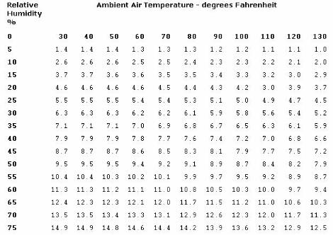

Mattia
When I asked about RH a few months ago Tom Morici posted the following which may interest you. It shows how the moisture content of the wood changes at different RH and temps (apparently you need to aim for 8 MC.
Richard
