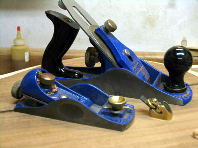

I use 3. I think you will have to decide which would be the best to start with. The two blue ones are Record. They are great planes for a resonable price. About $100 and $50 as I recall. The big one is great for planning plates to thickness, and joining parts. The block plane works great for things like radiusing braces, trimming the sides and most smaller jobs. I use the Ibex for shaving braces.

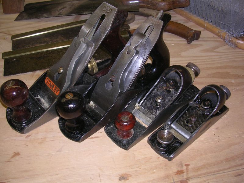

I've got about $100 bucks in these eBay pretties... incl. shipping!
