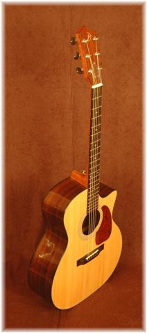

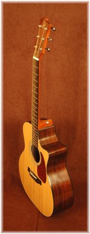

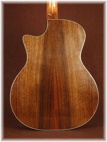

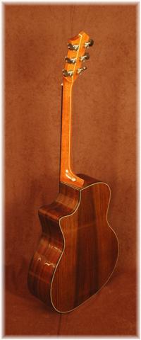

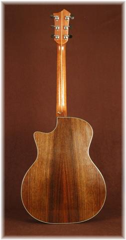

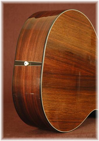

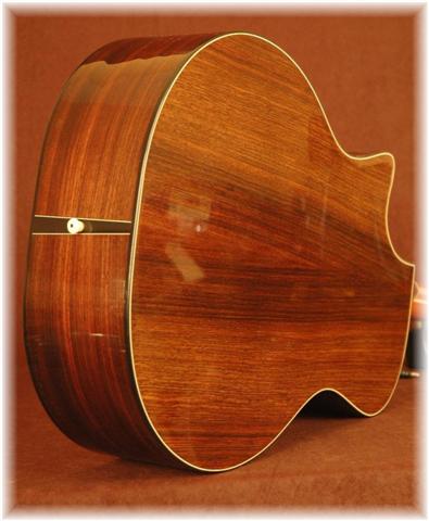

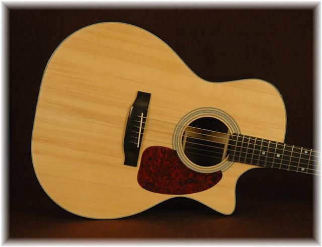

This is number three. I made it for my brother. The finish was horrible. It came back home before Thanksgiving, slated for a refinish job. Needless to say, I wasn't looking forward to it.
When I got the guitar, I realized how much I'd improved on the two guitars since. The neck was unacceptable as well as the finish. This guitar just made the trip back home to Texas. I'd like to share the results.
No, it's not perfect. There is still room for improvement. But I'm happy to have sent home a much better guitar the second time around. It's breathing new life with a better finish and a reshaped neck.

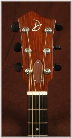

This is Indian Rosewood (allied) with an adirondack top (old standard) a honduran and maple neck (hogan). Body shape is grand auditorium (taylor), neck profile, (now taylor). Tail pin from a vintage D35, my brother saw it in my junk drawer and wanted it? Go figure.

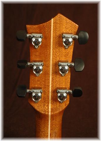

Grover tuners with ebony buttons. LMI compression truss rod with glued in spline. Finish is fourteen coats of McFadden's lacquer, filler is the previous coat of hardware variety polyurethane. (not recommended, it's the reason I had to refinish)
Buffed with my DIY buffer posted on my website, 3M wet buffing compound, very messy. Then Menzerna fine white bar compound on the other wheel. Finally I used MacQuires 9 swirl remover by hand, and then MacQuires 7 polish by hand as well. Also, Ace polishing cloth available in the cleaning products section.
My brother has no idea how much work went into refinishing his guitar. It doesn't matter. What matters is, I'm proud of it again.

Dave, What's different? The finish itself. A change from Ace Polyurethane straight out of the can to McFadden's Nitrocellulose Buffing Lacquer.
Thanks everyone for the compliments.
JJ, the defect in the finish was the complete lack of pore filling. Spraying straight polyurethane, with no filler, left the surface of the rosewood orange peeled or pitted where each pore sucked the finish from the surface. The Spruce looked good with the thin poly finish, alas there were no pores to fill.
I will say this, polyurethane is a good sealer between rosewood and nitro. I say that because at the same time I was spraying this guitar, I was spraying a rosewood without poly on the surface. That guitar fisheyed big time along the back join. This guitar with a good coating of thin polyurethane took the lacquer like a champ.
The main problem I had spraying polyurethane is that my gun had too small a tip. It should have been much larger like 1.8 mm or 2.2 mm. I was shooting with a touchup gun and only a 1.2 mm gun tip. Let me say this, I know of a quality builder and all he uses is Ace Poly after many guitars came back to him with crazed Nitro finishes.
This guitar can be seen on my website under Paul D, Grand A! www.dickeyguitars.com with the poly finish.

Actually there was no pore filling on this guitar as a separate step.
The thin original finish allowed all the pores to show. At the time I did not own a buffer. While it looked nice, it was not by any means a great finish.
The poly acted like a great sealer for subsequent coats of Nitro though. I scuff-sanded the entire guitar wet with 400 grit and started over with the finish.
The nitro began building immediately without crawling, fisheyes or sinking into pores. It turned out much better than the other rosewood guitar done at the same time.
I'm definitely going back and trying epoxy fill again. I used it on number five but found it way too thick put on with the Rubbermaid Spatula from the kitchen....
Looking back at all the things I've tried I sure get a big laugh.... like John Hall says, learn from the mistakes of others. There isn't enough time to make them all yourself.
