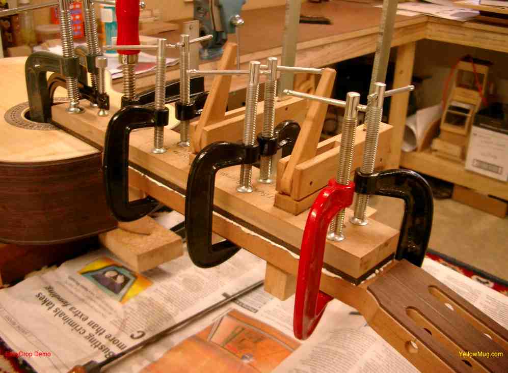

James...Here's how I do it:
1)Install all but 2 of the frets. I leave the first fret slot and the 13th slot unfretted (11th slot if it's a 12 fretter)
2) Perfectly align and clamp the FB to the neck
3) Drill a 1/16" hole through the treble side of the 1st and the bass side of the 13th and just a tad through the neck surface
4) Apply your favorite glue (I use epoxy) and insert the smooth ends of 1/16" bits (or smooth pins) through the holes and into the neck surface.
5) Clamp it up and have a beer! Remove the pins after the glue sets up...about 30 minutes with the epoxy I use.
6) Allow to set for 24 hours, unclamp and install the 2 frets

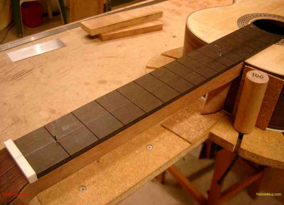

    I use location pins and have used both methods of fretting before and
after gluing the fretboard to the neck. I prefer fretting after the neck is
set and has been in place for a day or two simply because it allows me to
address the entire length of the fingerboard for leveling before fretting.
   I use an 18 inch long radius sanding caul to flatten the entire length
and to be sure that the fingerbord is true and the approach toward the
bridge is free of any humps or low spots.
   I use two pins to locate and stabilize the board for gluing. They are
3/16" roll pins and are located between the nut and 1st fret on the treble
side of the board about 1/8" outside of the truss rod slot and the other
falls between the 12th and 13th frets on the bass side the same distance
off of the slot.
   The pins are short enough to be securely set into a 1/8" deep hole in
the fingerboard and a 3/16" deep hole in the neck. This provides great
solid stability without a risk of beng able to break through into the holes
while shaping the neck.
    With this method, ther's no need to cover up any holes or to leave frets
out or of having frets pushed out by pins that are located directly under
them.
    You'll find lots of alternatives when choosing a method amd materials
for this and one will work best for you and provide great results. This is
just my preference.
    The roll pins also offer a bit of ability to be compressed in their
circumference as woods expand and contract with environmental changes
so there's no risk of them causing any problems.
Regards,
Kevin Gallagher/Omega Guitars Kevin Gallagher39089.8816319444

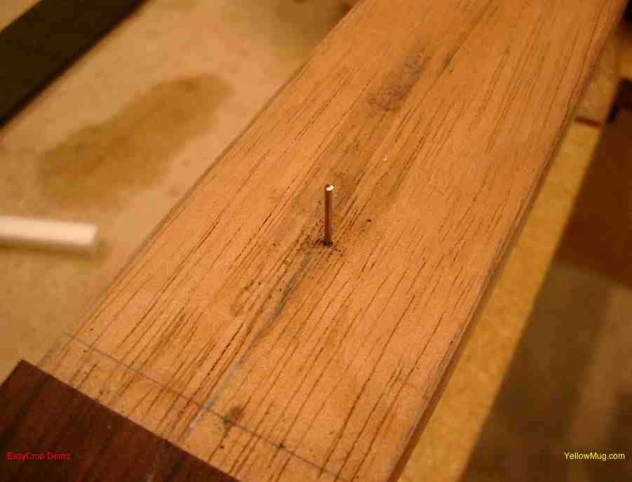

James, i did that on no 2, the same way Kathy Matsusita does except that i cut 2 very tiny finishing nails in half and pushed them through the fret slots with a very small punch, a tad deeper than the slots were, no chance of moving whatsoever. Of course, i did drill 2 tiny holes first.

I do it slightly different. I have a template that matches my fretboard and
neck taper that has 2 holes drilled through it, one in the 1st fret area and
one down around the 12th I do believe.
I align the template on either piece, order doesn't matter, and with the drill
press drill the 2 holes into the neck and backside of the fretboard (very
shallow-about a 1/16th on each). I then take a cross-section of hot dog
roasting stick about 1/8" tall and glue into the holes I drilled into the neck.
Apply glue, then align and place the fretboard's corresponding holes onto
the stub of the protruding stick and clamp.

This is all very helpful -- thank you! I was thinking I'd touch my
soldering iron to the pins to pull them out of the glue. It sounds like
many of you leave them in?

[QUOTE=James Orr] This is all very helpful -- thank you! I was thinking I'd touch my
many of you leave them in?[/QUOTE]
You wont need a soldering iron. Just leave enough oin protruding to get a grip on same with a pair of nippers. Just make sure you dont lever nippers against the fretboard and damage same. My pins just pull straight out without need for levering.

Something I learned from Mark Swanson several years ago, shoot a couple of staple from a staple gun to the underside of the fb. The wood is so hard that the staple barely sets into the wood. Nip off the ends to just leave a little nib of the staple, align the board and press down into the mahogany. Now you can take off the board, apply the glue and reset into the holes and your good to clamp. Staples stay in the neck, sort of the same as Kevin's and Chris'

No problems with a truss rod as its a classical. On my steel strings the pins are positioned clear of the truss rod.
