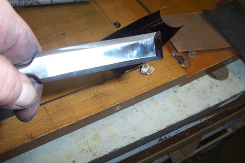

Hi folks, after watching a video that was posted by my good pal Rod True, i decided to give that a try and the results were quite amazing for my very first try at sharpening chisels, better late than never they say huh?

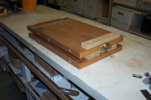

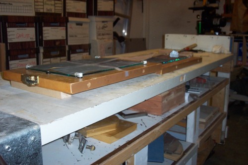

I purchased 2 glass plates from Lee Valley and inserted them in a foldable jig of sort then i proceeded with different grits, dry on the first lower grits and with water on the higher ones, polished them to a mirror sheen at the end, i still need a bit of practice but with good elbow grease and good will, i think i'll have them all sharpened very soon, thanks Rod!
Her's the jig
Here's the result!
Thanks for tuning in!

Hey Serge,
That looks like a great set up to hold the glass.
Great idea!
PostPosted: Sun Jan 07, 2007 4:54 pm
Thanks Jim, i used mirror hooks?clamps? plastic thingies anyways, they help keep the sandpaper down in the corners and the plates down on the surface.

Now Serge, that looks great. Did you do them by hand or with a honing guide?
If you don't have a honing guide, I would suggest getting one. Even a cheap one is better than going at it by hand. Makes for a more even bevel and for a nice square edge. If you have one already, just ignore me
I must say thought that that chisle sure looks good Bro. Rod True39090.0581944444

Rod, i do have a sharpening guide but how could i ever ignore the guy that delivered me from my ignorance?
I have the same exact honing guide as the guy in the video but mine seems to be wobbly a bit, i am seriously considering buying another one from Lee Valley that would certainly be more sturdy and accurate although pricey!

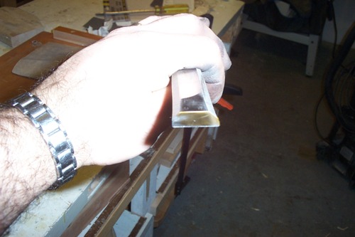

PostPosted: Sun Jan 07, 2007 10:19 pm
Posts: 1055
Hey Serge, thats a lovely hairy arm in photo No 4.
Just perfect for testing chisels on! kiwigeo39090.2644212963
