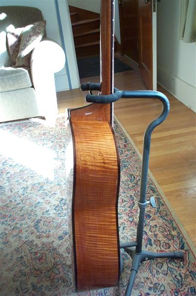

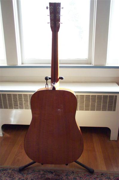

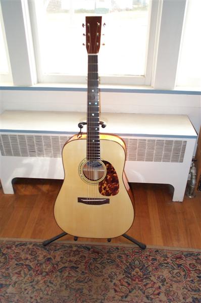

Number 3 has been done for a few weeks, just tweaked the setup and thought I'd post some pics. As usual, forgive my horrible photography skills!
B/S: Curly Hondo Mahogany
Top: Carpathian Spruce
Neck: Hondo Manogany
Fretboad/Bridge: Bois D' Rose
Binding: EIR
Finish: FP
Thanks for looking!
-Mark

Nice work Mark! very clean lines and craftmanship.
PostPosted: Mon Jan 08, 2007 6:34 am
Very nice, Mark. I like that a lot.
What a delicious dred. Man that's great.

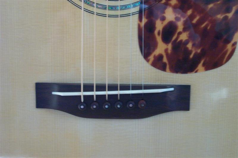

I love the traditional bridge and through-saddle. Looks super clean.

    That's a beauty Mark ! I love the traditional look including the through
saddle bridge.

I'm not a photagrapher by any means, but one tip I can give you is to find a less busy background for your instrument, and more importantly, avoid lighting it from behind, it leaves the instrument really dark.

Wow, thats a nice one--what kind of pickguard do you have on it?

Cool saddle.Don`t mind if I steal that little slope at the edges do you.   James

af: Pickguard is the plastic tortise from Stewmac.
James: The slope in the saddle is just a product of running the slot the entire length of the bridge, then profiling the the saddle to follow the slopes on the wings of the bridge - the old Martins were done in this manner. Steal away - I did!

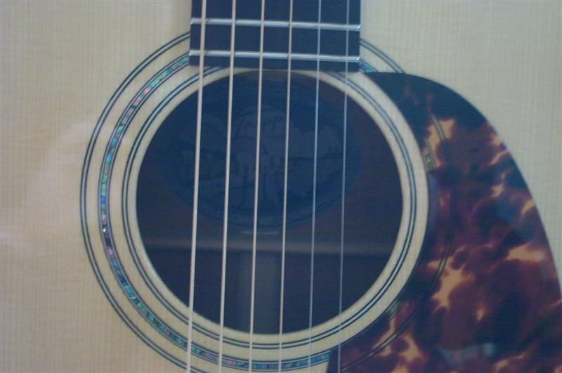

Love the overall look of your guitar. The rosette, B&S wood and long head stock & long saddle are all outstanding, as well as the workmanship

I'm a French polishing fan and you've done a tremendous job here. The elbow grease has paid off. Love the choice of woods and bindings.

I love the rosette, the zoot and your FP looks amazing!!!
