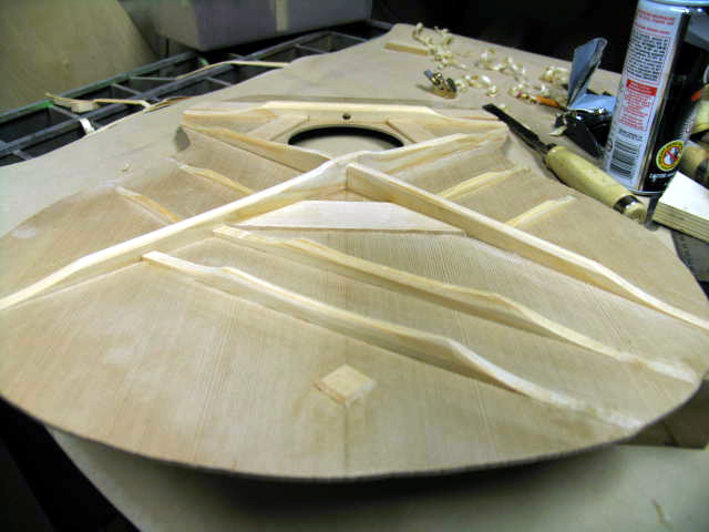

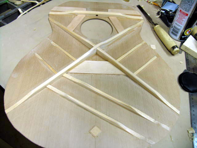

I'm in the process of doing my first SS top (only built classicals until now) I'd love to get some constructive criticism before I finish carving and clean it up. I won't even mind taking a brace or two up and replacing them if it is a good idea. Don't hold back, I can use the help!!!!
The x-brace is 5/16 x 5/8
It is a .120 cedar top, medium stiffness, on a SJ body. I'm going for a mostly fingerstyle guitar using light gauge strings. I would like it to stand up to a pick on occassion.
Thank you for any advice you can give.

just from looks I'd say try to triangulate the lower face braces a bit more. (of
course it is hard to tell from pics) but it looks like they could be less and still
hold good (assuming of course the top is stiff cross grain)
PostPosted: Fri Jan 12, 2007 2:54 pm
Hey Joe looks good.
Of course it's hard to tell what to change with out hearing the tap.
You can take the x-brace cap down to like 1/16", it doesn't need to be that high at all.
You could tapper the x-braces down probably a little bit too.
What are the tone bar dimensions?

Thanks Rod, The tone bars are 1/4 x 1/4 and the lower face braces are both 5/16 x 1/2.
The tap town right now is fairly high pitched wit a lot of ring. I'm thinking it might still be to tight?

I agree with John's comments about the lower face braces (I call these the tone bars, but I probably need some more educatin')
I make mine lower face braces 1/4x1/2 and on the lates one I've got closed up they taper down to nothing with out the lower scallop peak. But this is only because it sounded to tight with them peaked like you show.

Do you tapper the face braces to nothing at the x-brace? I was thinking that was something John recommended for a tight top.

I don't understand, why is one x-brace so much higher than the other?

they both started out as 5/8 high. I added a cap over the x. Is that what you are referring to?

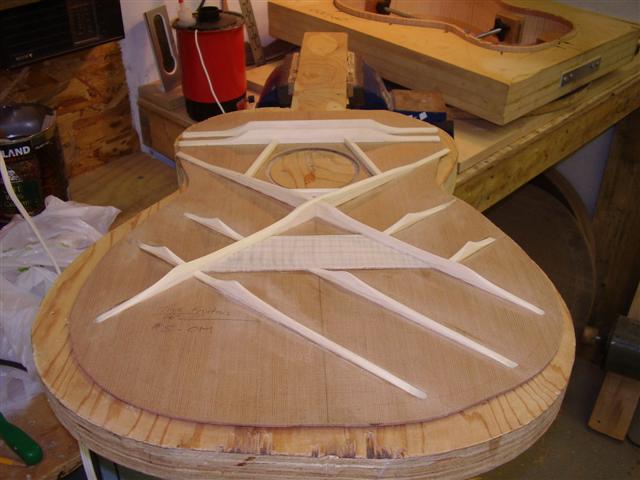

Since I think I'm getting lost in the wording, I'll repost my top bracing pic which Bruce Dicky post a couple of weeks back.
Please, Please know that this is only the 5th guitar and there are many many other's here considerably more knowledgeable with voicing a top than I am. I just keep tapping the top and shaving until I'm happy with the sound that comes out. I want the top to ring for a couple of seconds at least and not just "tink".
I have a lot of learning to do and have read more than I can even really remember. At some point you just need to try things and not be afraid to go to light in the bracing. We will only know how light we can brace when the guitar implodes and we can say "well, I braced that one to light "
Anyway, here is the picture if it helps at all.
Oh and just so you know, this is an OM guitar, cedar top, all the bracing is 1/4" wide but for the two upper transverse braces, They are 3/8".

Thanks Rod, Looks like nice work to me.
