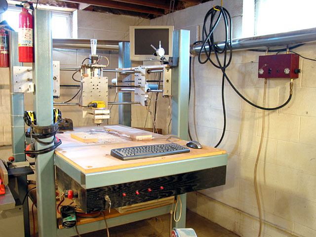

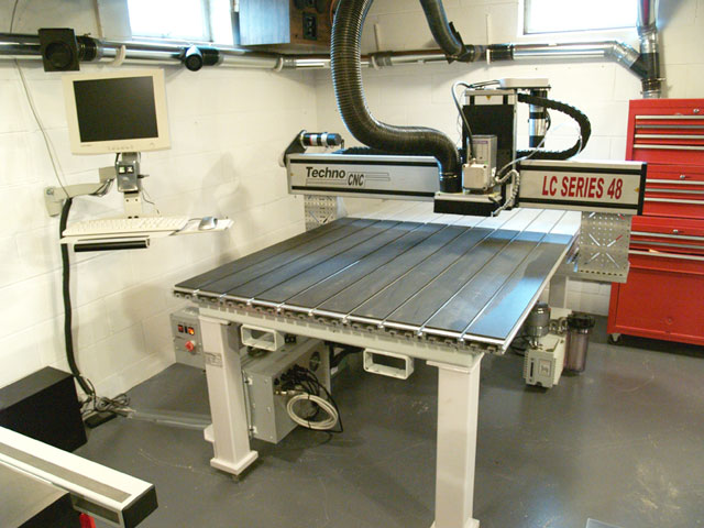

Seems like you're on the right track, Mattia. The machine I built served me well for 3 years. It just couldn't keep up as my business grew. I wouldn't have hesitated to build it's replacement from scratch either, I just didn't have the time.
The only advice I would give is to take your time with it and to buy the motors and drives last. That way you can put all of your remaining budget into them. Go servo if you can.
Here's a pic of my first machine and the current beast.
