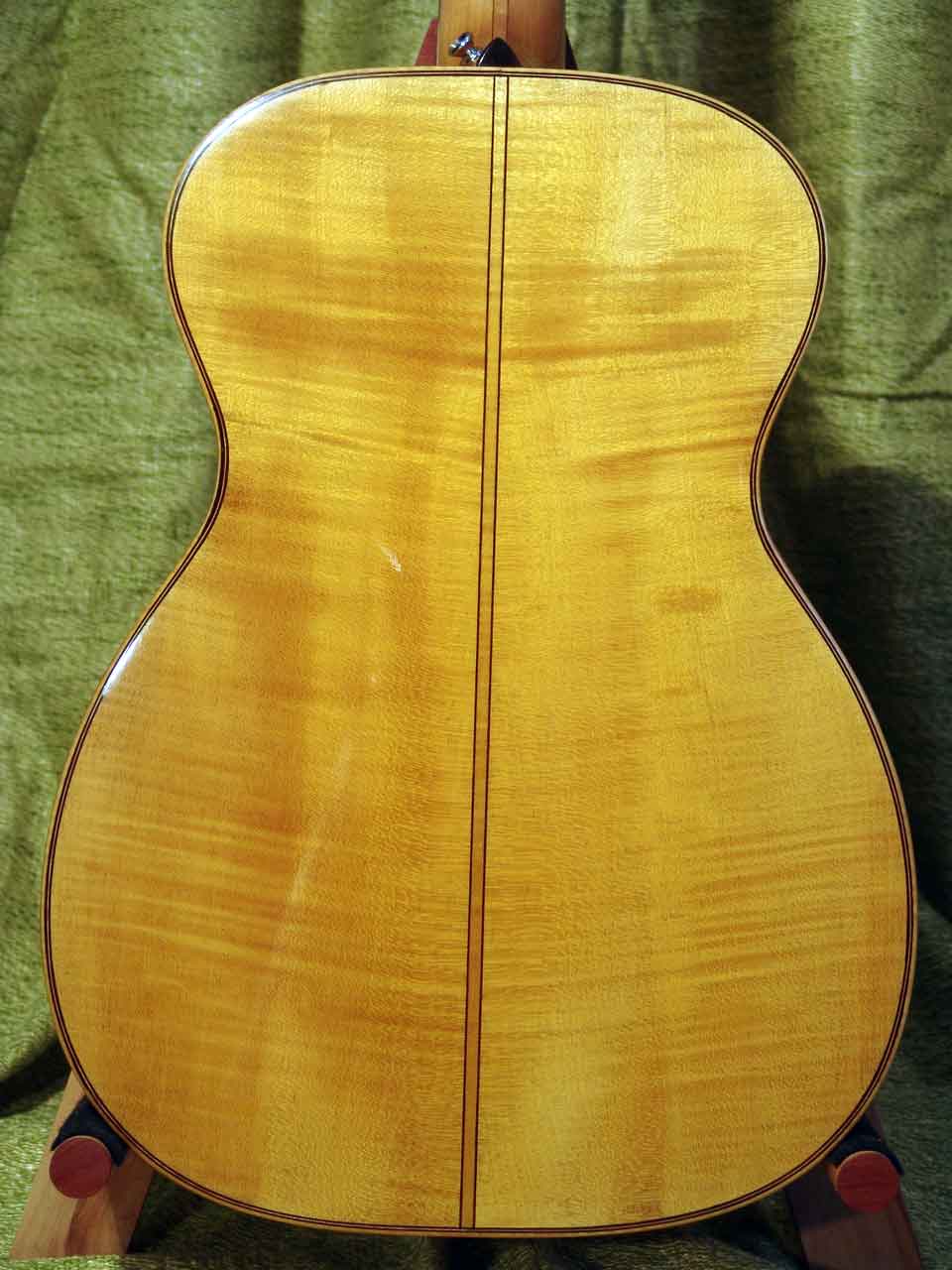

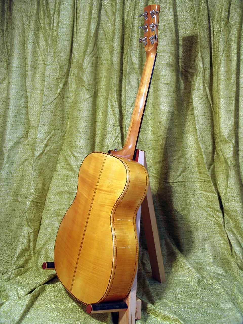

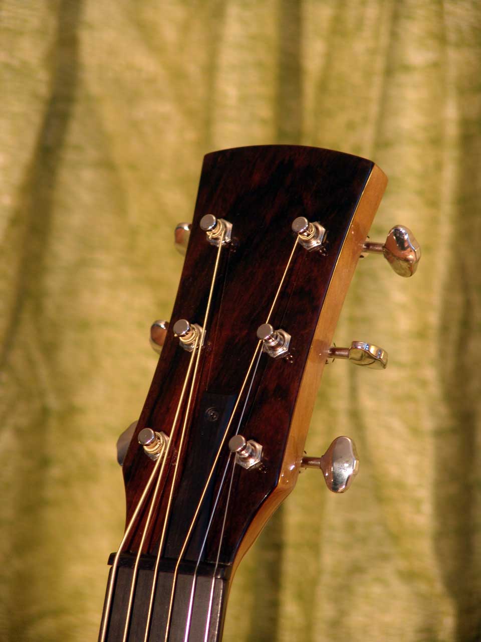

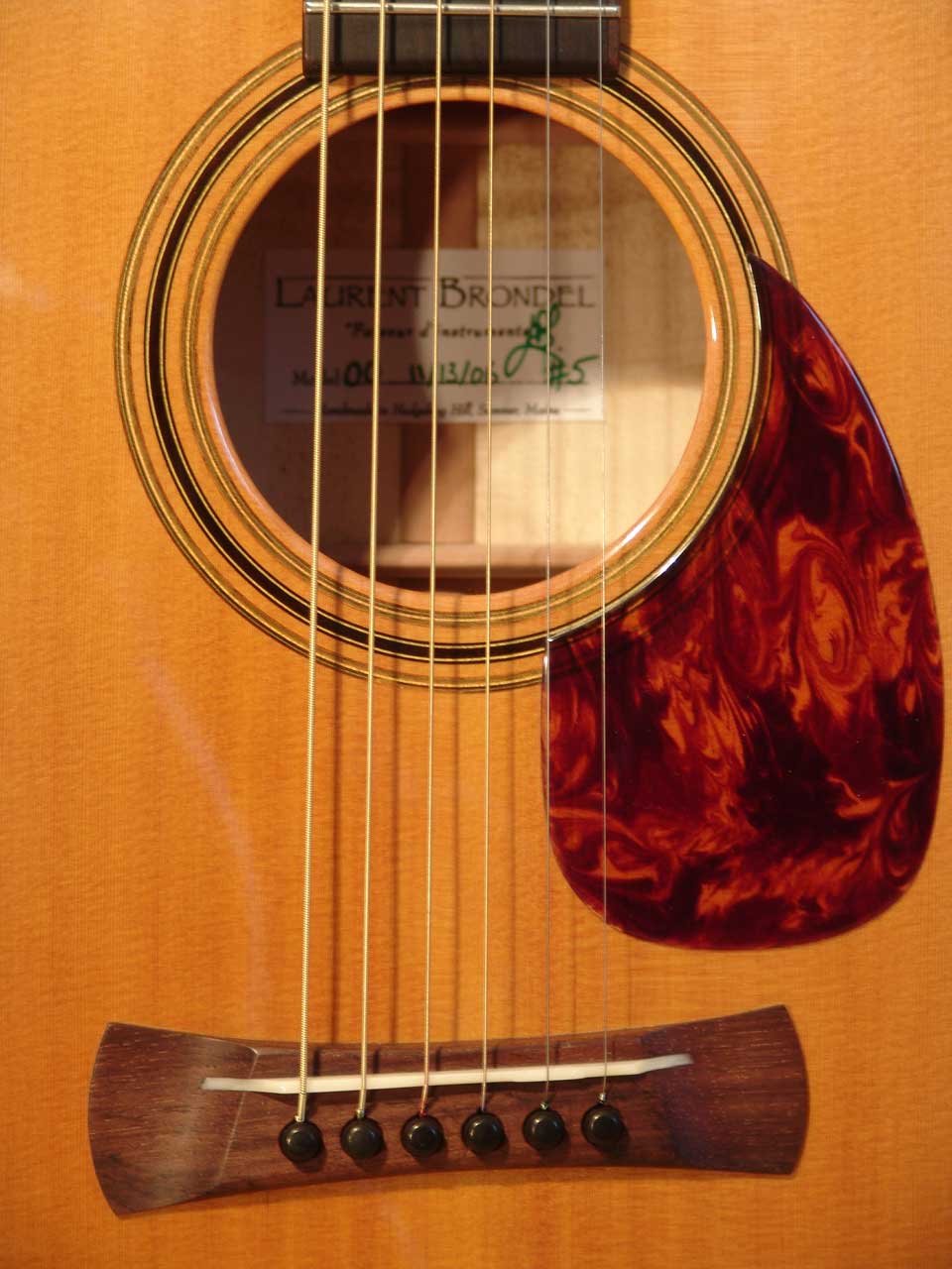

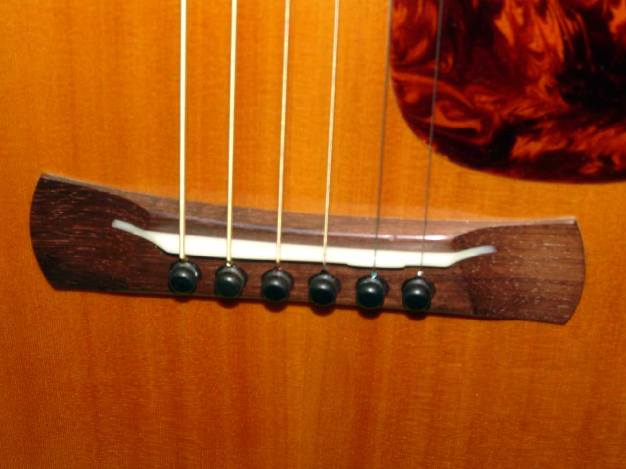

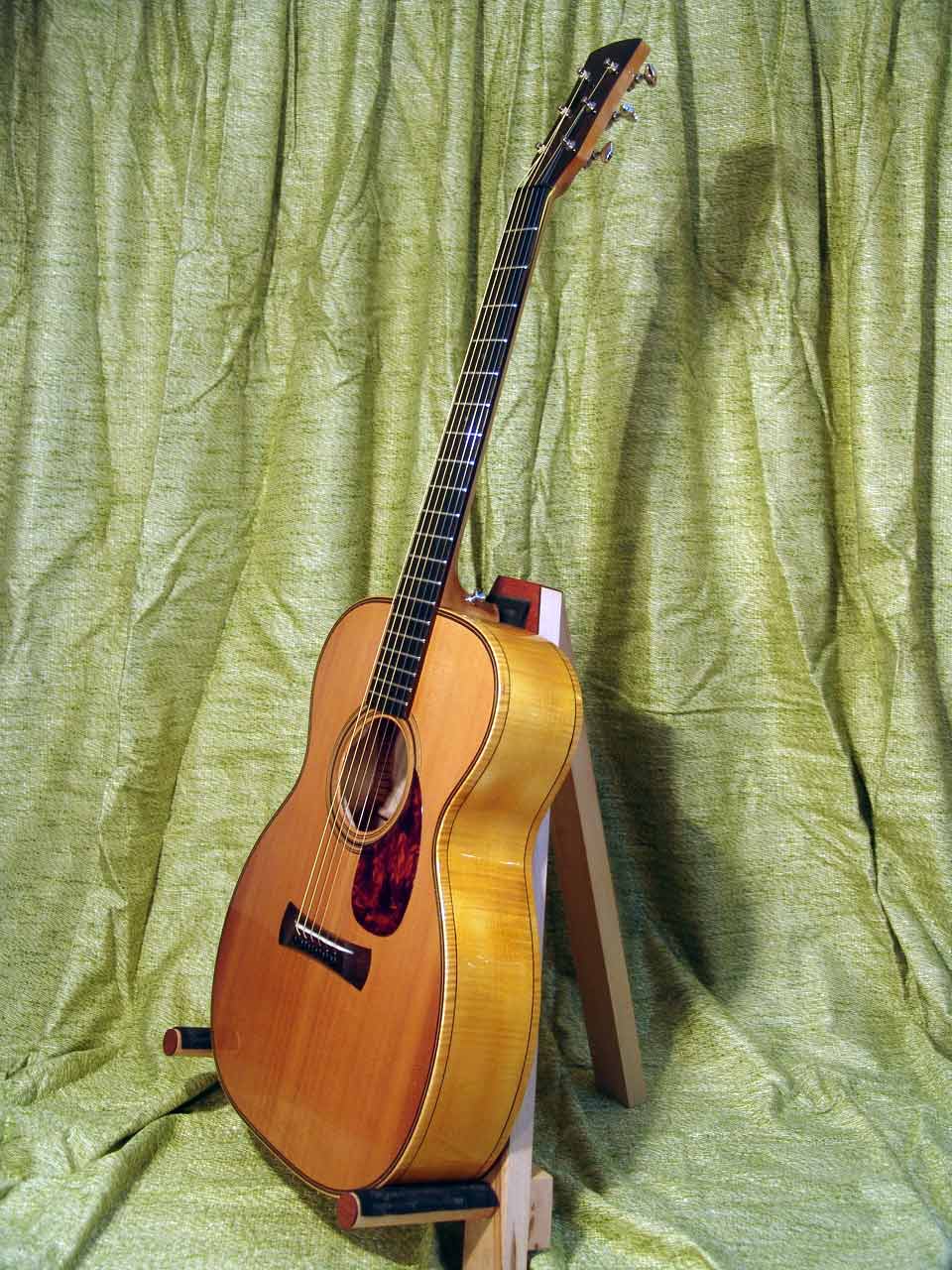

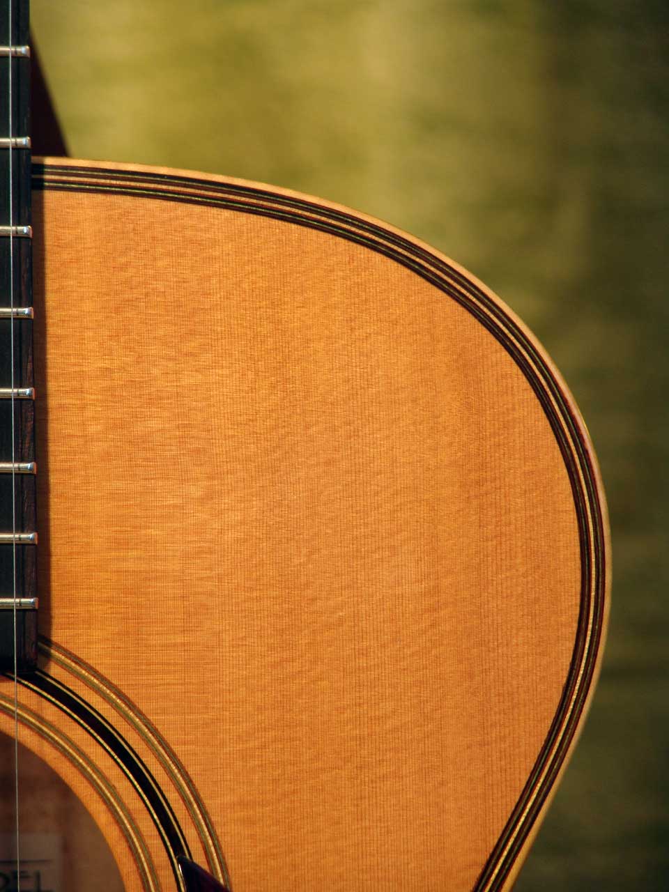

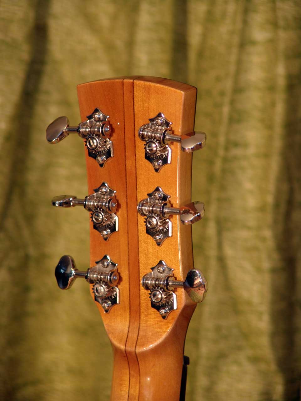

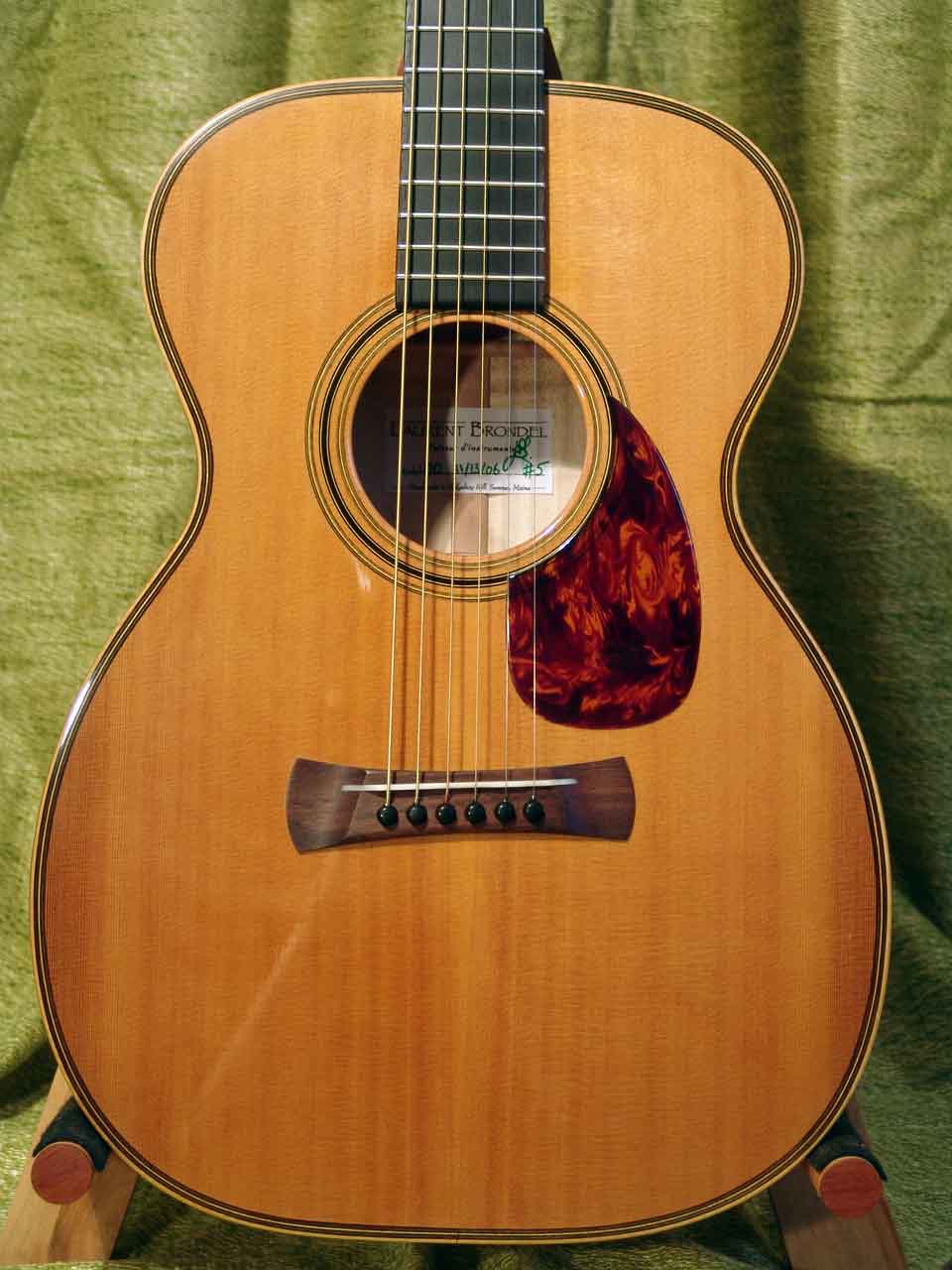

It's me again, I promise I will stop very soon… Here's a 00 14 frets I
completed sometime in November, I took some pics this morning.
Here are the specs:
Western red cedar top
German maple back & sides
European cherry / black walnut laminated adjustable neck with slender
flat profile (classical style)
European cherry neck block, end block and back braces
Sitka spruce top bracing and maple bridgeplate
Spanish cedar kerfing
Ebony fingerboard, nut and bridge pins
Brazilian rosewood bridge and peghead veneer
Maple, ebony, wenge, cherry and greed dyed maple trim
Bone saddle
Gotoh Sta-tite open gear tuners
Paua shell fingerboard and side dots
Tor-tis pickguard
25.7" scale
Nut width: 1 3/4"
Bridge string spacing: 2 3/8"
Hand applied varnish finish

WONDERFUL!
What a nice guitar and great wood combo, tastefully elegant Laurent!

Very tasteful and clean work.
Beautiful!

        BRILLIANT !
Geez ! I've just seen Howards new one , and now this !
Could you cut it out you guys !,,,,(please )
Truly beautiful work. My day is ruined,,that's for sure.
Congratulations , A superb Guitar

Really lovely. Love the binding choices especially.
PostPosted: Wed Jan 17, 2007 10:57 am
Laurent that is truly elegant. Great wood combinations. There's something about a varnish finish that gives the wood a warm glow. Very nice indeed.

Laurent, you old trickster! I hope I can build a guitar that looks and sounds that good when I grow up. Great tone, fine playing!
I really like the guitar's quick attack. Could you tell us a bit about your bracing pattern and shape?
