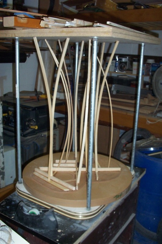

Mike, here's a pic of a 25' radius dish in the go bar deck, the guitar top is in there with the braces that have been sanded in the same dish with a big round sheet of 80 grits sandpaper and their bottoms now at the same radius of the dish are being glued on the underside of the top with flexed bars , hope this helps! Serge
