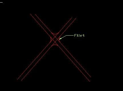

In one of the Somogyi discussion I asked about adding some small fillets to the X brace. It seems that this joint is vital to the guitar and some small fillets would add a lot of strength without adding much weight.
Has anyone done this?
Any thoughts/observations?

[QUOTE=Rod True] Steve, do you mean to cap the x brace?
If this isn't what your talking about, than forget my post, but please elaborate [/QUOTE] No, I don't mean to cap. I didn't explain it very well.
I mean to add a radius to the joint like in the drawing below. It would be made from the same wood as the X brace and glued in place.
Fillets add lots of strength.

Posts: 2692
They would IMO strengthen the joint in directions in which it is not stressed much.

PostPosted: Wed Jan 10, 2007 5:08 pm
Here's my 2 centavos.
If the stresses were parallel to the top, going radially around the x, as if they
were opening and closing the x, the fillet would be a good thing. But the
stress on the top is almost all perpendicular to the top and little benefit
would be had, I think.

[QUOTE=Rod True] I guess the real question is.....do we really need it?[/QUOTE] Rod,
Do you think the real question could be.....does it improve the sound of the guitar or make it more durable without adversely affecting sound?

It seems that it would increase the strength of the X joint to a point where it may not flex like we want it to.
Strength, to a point, is a great thing...beyond that, it hinders the movement of the sound. Seems like a lot of work to add the fillets.

PostPosted: Wed Jan 10, 2007 5:22 pm
Well......it could be the real question, and sounds like it's yours
I don't know that answer to that but I certainly can speculate.
I would think that this area of the bracing doesn't vibrate all that much as it is probably the stiffest location on the top, other than the glue joint between the head block and the top plate, so I suspect that you really wouldn't see any difference in sound with or without it.
Would it make it more durable....there are lots of 60+ year old guitars out there without it.

I thought about this while watching the Somogyi video while he stressed how important it is to have a great joint there. I think he mentioned that it was vital to have a well executed joint. Perhaps a couple of fillets could make a mediocre joint good and a good joint even better.
Just thinking a bit. It doesn't seem like it would hurt anything. Perhaps it won't help. But what if it does?
I only know one way to find out. I'll ask Ervin.

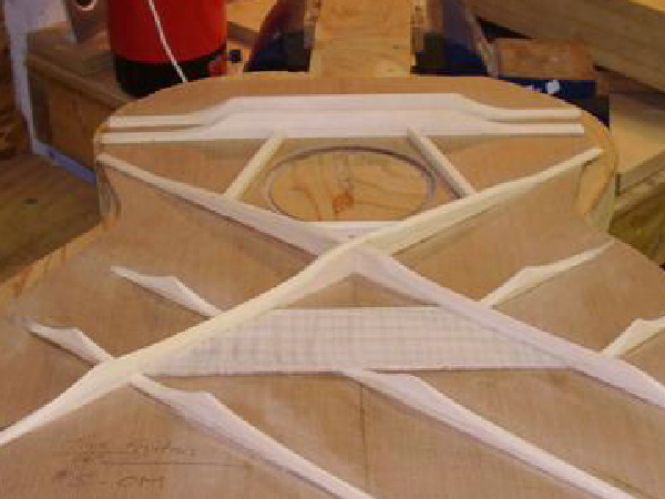

If you look closely at that pic of Irvin's guitar, you'll see that it does have a cap over the open part of the box joint. Since the bridge torque tends to stress that area highly, some sort of cap is, IMO, nessecary. Even the round linen patch that many manuufacturers have used for years helps a lot. I recently put one on a Taylor that one of my students has, that developed the split out from the bottom of the box cut that is all too common in unreinforced ones. The brace tops were so narrow that it would not have done much good to put on a wood patch, but the linen one, put on with hot hide glue, seems to have worked well. The hot glue just sucks the cloth right in tight to the brace after it gels, and makes a surprisingly strong joint.

I once used a prefab brace set from Grizzly, and there was no way to put a cap on top. The X braces were radiused on the top, even at the joint. Not sure if they still do them that way.
Anyhow, I think I should put a gauze patch on. Good idea.

[QUOTE=fmorelli] .....I can see no reason for fillets (strength is in the wrong direction with a fillet.....[/QUOTE]
Please don't think I'm picking on you, I'm not. Others have said pretty much the same thing. I don't understand the idea of strength in the wrong direction. A fillet doesn't add strength in just one direction. The fillets would enhance strength in the same directions that the glue inside the joint adds strength, yet no one would ever not glue the joint.
I'm not trying to be argumentative.
I'm not even bought into the need for fillets. I'm just trying to discuss and explore the idea.
The objections to the idea, at least to me, don't seem as sound as the idea.
Perhaps I'm a little slow and just don't get it. Perhaps I'm not. Who knows?

[QUOTE=SteveS]   I don't understand the idea of strength in the wrong direction. A fillet doesn't add strength in just one direction. The fillets would enhance strength in the same directions that the glue inside the joint adds strength, yet no one would ever not glue the joint.
Steve:
I'm with you on this. If you think of two fillets and the intervening brace wood, they are reinforcing in just the same way that a cap does.
I've used fillets (epoxy) in boatbuilding (a lot) and they stiffen the joints in all directions.
I don't see any problem reinforcing the 'X'- this is surely one of the most rigid areas of the entire top, so any reinforcement wouldn't be likely to degrade the sound much, I'd think.
I may do a few tests with some scrap. This is interesting.

Filippo wrote:
"Since my X brace was (classic Martin) scalloped and equal height, I mixed wood glue and wood dust, and simply fill the gap until it was solid from top to bottom. Looks good, easily as strong now in both directions. "
It may seem so, but it's not.
We're talking about a 'box' or 'half-lap' joint here.
If the brace is 6mm wide and 14mm tall, you cut notches in each brace 6x7mm at the crossing point, one notch in the 'top' of the brace, that faces toward the top plate, and the other in the 'bottom', that faces into the box. Being a good craftsman, you cut these tight, and glue the joint on all surfaces, of course.
The notch that faces 'up' is bridged over by the wood of the plate. The notch that faces downward is open. Of course, it is filled in by the wood of the crossing brace, but that's only effective in resisting compression loads. On the completed guitar this part of the joint is in tension, since it's in front of the bridge, and the front edge of the bridge is pushing downward, trying to open the notch.
In your filled joint, the only thing resisting that tension load is the glue and sawdust mix you put in it. Wood glue is not really very strong in tension, nor does it stick well to end grain, due, in part, to the shrinkage as it dries. So there's not much holding that part of the joint together.
Once that lets go (and it will) you've got a situation where there is a lot of stress concentrated in a small area. This is because the stiffness of the brace goes as the cube of the height. At the notch the brace is only 1/2 as high as it is on either side, so it's only 1/8 as stiff. It 'wants' to bend a lot more right there. This puts a very high load on the wood just at the corner of the notch, where the stiffness changes suddenly, and it is not unusual for the brace to crack right at that point. Once it does that whole area of the top is much less stiff in that direction than it is supposed to be, and it dips down. I can't tell you how often I've seen this on old guitars, or even ones, like my student's Taylor, that are not all that old.
You can also see the effect of that stiffness difference if you look at the way the 'free' plate vibrates. Ones without the patch over the joint have quite asymmetric modes, and they clear right up when you add that little patch. It's not as obvious on completed guitars, of course, but it probably makes some difference.
As I say, for braces like those in kits that are pre-rounded, or tapered in width near the top, the cloth patch makes a surprisingly large difference. It's not as good as a wood patch, but it's sure better than nothing.
