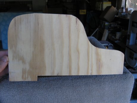

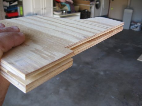

I used a sacrificial push stick made in 2 minutes from 3/4" plywood. Used a shape found everywhere on the internet. Just cut right through the bottom of it. Worked great.
You can see the simple notch cut by the saw.
Felt really safe and I hope it helps someone else. Did not use a feather board but will have one built soon.LarryH39096.5901388889
