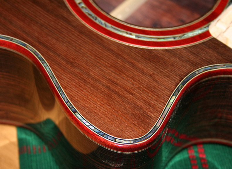

PostPosted: Sat Jan 20, 2007 5:21 pm
Peter, once again, she's just sooo gorgeous!
