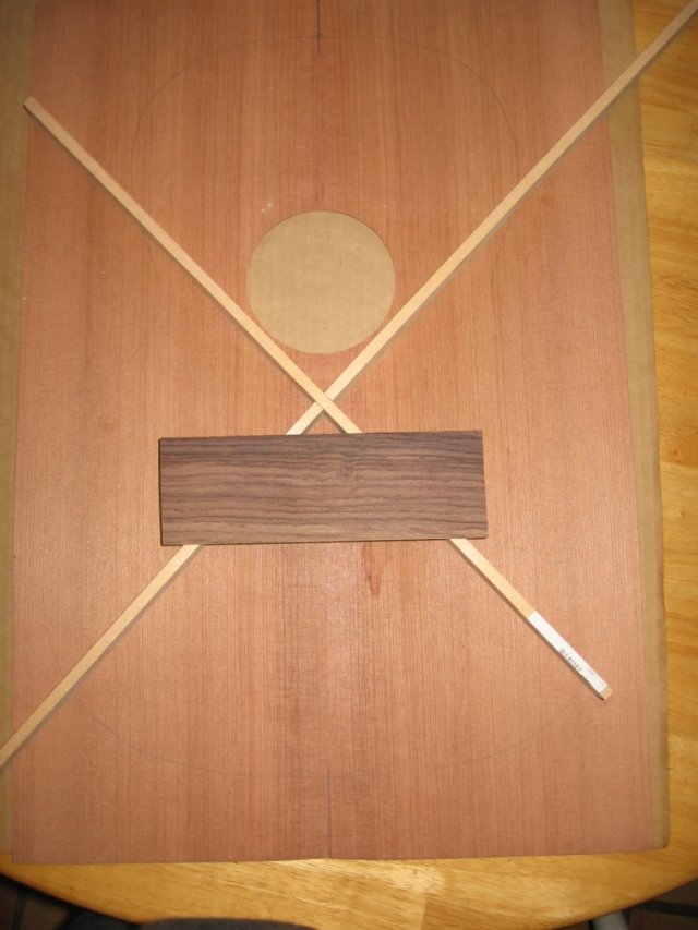

I'm just beginning to layout the braces on my 000 12 fretter and cannot seem to visualize the brace layout. It seems with the sound hole so low and the upper bout so small that in order to get any breathing room below the bridge plate for tone bars (which I won't use, I'll use a fan system instead) the angle have to be weird or the braces will meet the guitars edge right at the waist.
Is bracing a 12 fretter different in this regard and if so how?
Thanks very much
I hope you can make out the outline of the guitar in the pic.
Thank You and Best To All

But how about in the mean time could you check your 12 fretter plans and tell me a couple of things? Like where the braces meet the waist? At the waist, above the waist, a little bit? A lot?
How much clearance between the sound hole tangent and the X braces?
Are the X-braces 90 degrees? Less? More?
Does the layout in the pic look close?
If I get the X right I'll fake the rest.
Larry

I've not built a 000 12 fret but that sound hole sure looks low on the body to me. You still have lots of room to bring the body outline down if that would help.
But if you want the sound hole there, I can't help you.

[QUOTE=Rod True] I've not built a 000 12 fret but that sound hole sure looks low on the body to me. You still have lots of room to bring the body outline down if that would help.
But if you want the sound hole there, I can't help you.[/QUOTE]
Thanks Rod,
I'm not wed to any position of much of anything as I am a very new builder. I own a Martin 000 12 fret and put the sound hole in the same location as the Martin and it seems to really pinch the area in the lower bout. It seems the sound hole pretty much has to go 8 frets down (about 5 1/8") from the top of the body though being a 12 fretter and all.
Again it seems that with the hole so low the X will meet the body very near the waist and leave a smallish area in the lower bout.

[QUOTE=LarryH] I'm just beginning to layout the braces on my 000 12 fretter and cannot seem to visualize the brace layout. It seems with the sound hole so low and the upper bout so small that in order to get any breathing room below the bridge plate for tone bars (which I won't use, I'll use a fan system instead) the angle have to be weird or the braces will meet the guitars edge right at the waist.
Thanks very much
Larry...
As I sit here posting, my personal 000-12, circa 1999, sits beside me for reference,
Your brace layout looks fine. My upper leg X braces exit the top just slightly above a line drawn across the top of the soundhole...yours look to be in the same relationship.
My guitar has a 90 degree X and is "advanced, so the upper X brace legs sit only about 1/8 to 316" in from the edge of the soundhole.
Given this geometry, your lower X brace legs will exit the edge of the top just slightly below the widest part of the lower bout...again yours appear to be in the ballpark.
FYI... Iuse a single wing brace off the lower X brace legs, just below the corners of the bridge. Also, I used only one tone bar on this instrument. As time went on, I did open my X up to about 94 degrees...this brought the upper X brace legs down a bit and raised the lower legs up to just slightly ABOVE the widest part of the lower bout. Opened up the tops even more than my personal unit, with more fullness and overtones...for you lush fingerpickers.
Hope that helps.
Hank

To me the soundhole placement looks fine - martins are 12 fret 24.9 scale with 20 frets, so the FB ends about the 21st or so - thats where the edge of a 3.5 (0) or 3 3/4 (00) soundhole would be. I use a 98 degree X, that looks to be a bunch less than 90 (at the soundhole). I place the X such that it exits the wings on the bottom edge, middle, not out the back corner. Bridge is 6 inches long.
Hope that helps.

Yeah John reckoned around 95 degrees would be OK and I will open the angle a bit for sure.
[quote]I place the X such that it exits the wings on the bottom edge, middle, not out the back corner. Bridge is 6 inches long. [/QUOTE]
Sorry I don't understand the terminology. ..."Wings on the bottom edge, middle, not out the back corner." Wings are what/where? Do they have a back corner?

Wings are the outer thinner ends of the bridge .. they need to sit on top of the X brace in your pattern to couple to the top and the X. So I like my bridge to sit on the X such that the X crosses and exits the wings of the bridge on the bottom edge of the bridge wing. Some make the bracing pattern such that the X will exit the bridge area out the back corner of the bridge wing.
If you take a look at the CAD bracing drawing that Michael Payne posted in the thread on the peak of an arched radiused top, you will see what I mean.

Larry...The following are some dimensions I took from the StewMac 000-12 fret plans...25.4" scale.
1) X-Brace...The intersection is 10.25" from the outside of the neck block. The spread is 96 degrees.
2) Soundhole...The SH is 3.88" dia. The distance from the edge of the SH to the X-intersection is 1.5"
3) Bridgeplate...Located 3.25" from the edge of the SH.
4) Tone bars...there are two
5) Finger braces...there are two but I've only used 1 per side.
