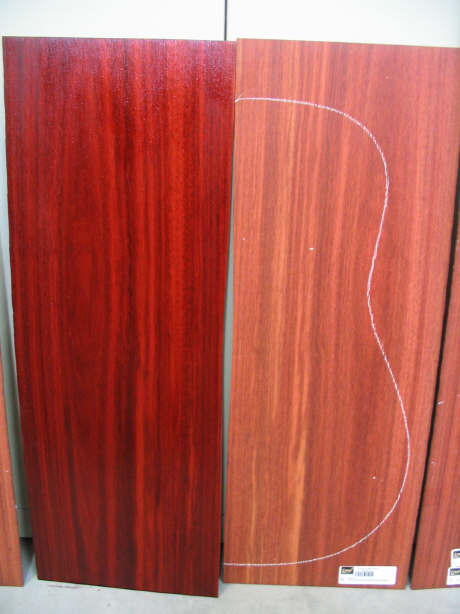

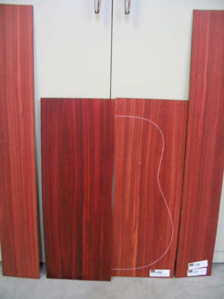

Thanks, Larry, for posting those.
BTW, for these pics, I thoroughly wet the back half on the left with alcohol. Never having worked with bloodwood before, I was amazed by how much red color came out of the wood onto my paper towel, and then, as the alcohol dripped down, onto the floor of my shop as well. I could have made a quart of brilliant red stain from what was coming out of this wood! No wonder it's called bloodwood - this stuff "bleeds" in the extreme! Seems like pore-filling and finishing may be a real challenge.
In your email to me, you asked what I plan to use this set for. If it were quartersawn all the way across, I'd probably use it for a relatively big guitar that I wanted to have a lot of volume and a big, full bass. This thought, again, is based on my observation that B/S woods with a very lively and glassy tap tone tend to contribute to loudness and a relatively dark, bass-rich tone. (I'm still interested to hear others' observations on this sort of thing.)
Since there's a flatsawn area about 2/3 of the way out from where the center seam will be on each half*, I will probably use it for a small body guitar (like a parlor) that I want to have a big sound with good bass. That way I can keep the outline almost entirely within the QS-to-rift area, and take advantage of the tonal quality of this wood to good effect (that is, the tonal quality I'm thinking this wood will likely contribute).
*Although the flat area is narrow and most of the lines look fairly parallel, there is actually a long, narrow oval there that you can see. It's not so much the appearance that I'm concerned about (although I don't, in fact, like the look of that), but the greater wood movement in that area.
I do think this set will make a stunning-looking small guitar. The colors and stripes toward the center are really nice.
If any wood suppliers are reading this, I sure would love to get some QS bloodwood sets with colors like this in sizes large enough to make a big acoustic bass guitar out of.
