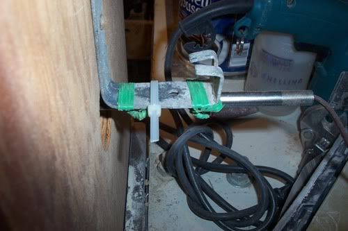

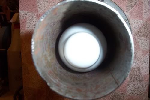

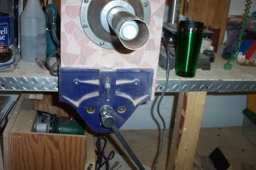

Yes, a heat source is a must, even for purfs, they bend easily on long curves but not always in tight curves, i posted my hot pipe pic a while ago, all you'd need would be a light bulb, a pipe and a flange plus a light bracket, i'll try to post a pic to demonstrate,
I since put a real light bracket fixture behind so that the bulb and tube stays dead in the center of the pipe, hope it helps
