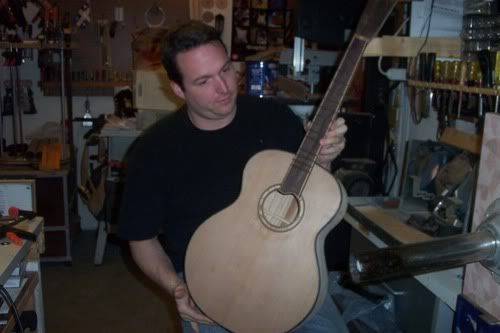

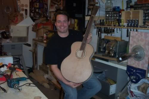

Hi folks, another truck load of pics!
My bud Alain visiting
And smiling!
Thanks for watching, some more coming!

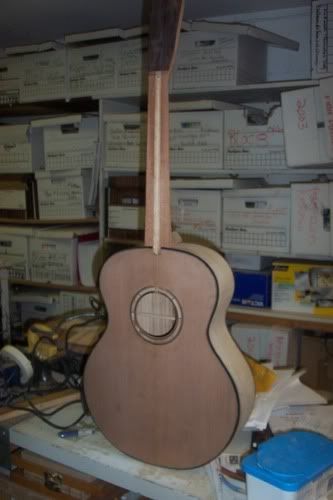

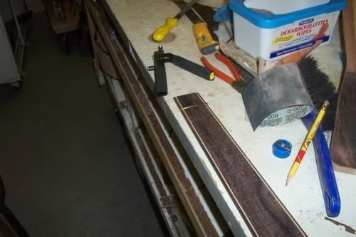

Wow! Nice, Serge! That contrasting stripe on the fingerboard turned out really well. The whole thing is turning out really well!
I'm wondering...did you get a backbow on your 'board by fretting off the neck? If so, did you have any problem flattening it out?
PostPosted: Thu Feb 01, 2007 10:35 am
Posts: 4820
At first I wasn't sure about the binding, but you've converted me. It looks
great, Serge.

Thanks fellas!
Carlton, yes, there wass a curve in the whole fretboard but it disapeared once glued to the laminated neck. The fretboard was really straight prior to the slotting, everything comes back straight on the neck if clamped really tight. Thanks!
Thanks Hesh, yes, always fun when me and Alain get together, he told me to hurry up and to string her up already!
Thanks James! Do you mean the binding on the fretboard or the box?
Thanks Charlie, oh ya betcha, next one is for Martin and i'll probably be building mine at the same time!
PostPosted: Thu Feb 01, 2007 11:07 am
Thanks Dave! I might FP the top, for the back and sides, i plan on varnishing, wet sand and FP over and finally buff over it all.
