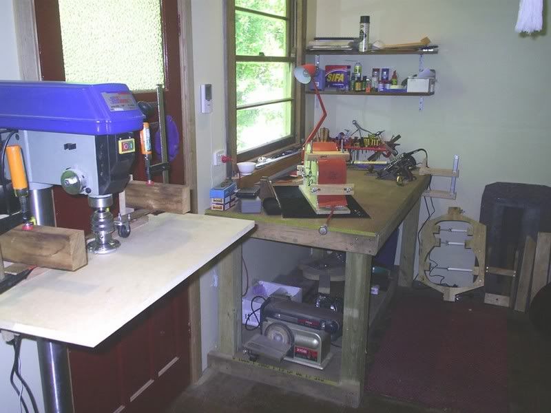

My workshop is nearing completion which i built using materials recycled from an old dissused shed on my property. This has been the biggest project so far to build the room in which to build guitars...and is fastly becoming my home away from home..a mans gotta have a shed.
and the inside ...although a bit sparse at the moment .I've basically just bought what I've needed to make jigs...I will buy what I need as I need it.

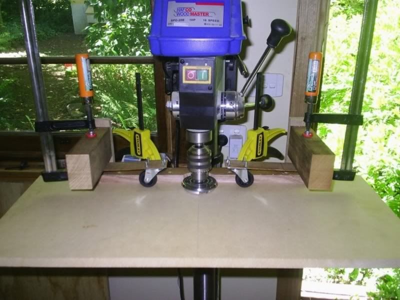

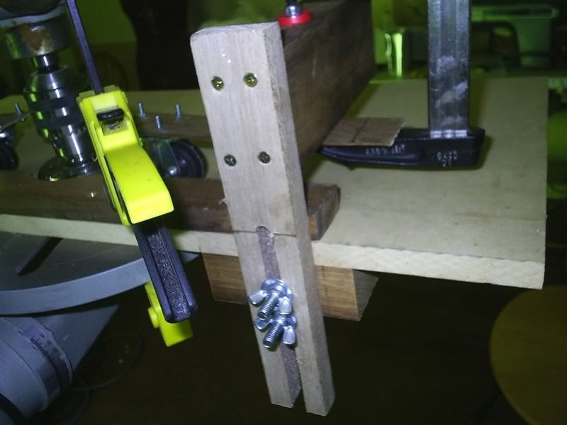

I got the idea for the hold downs on my safe-t-planer table from Todd Roses's post...I thought he had a great idea with the hold down wheel so i made something that does a similar thing...I just used whatever scrap material I had lying around.... seems to work quite well.
I decided to make a little frame so the hold down wheels can be adjusted up and down to whatever thickness is being planed...and i also decided to just use clamps for the wheels so that when the table needs to be moved back towards the pillar of the drill press the hold down wheels can be adjusted out to inline with the safe-t-planer.

Hesh, yes its just a drill press and I made a table for the safe-t-planer and i have another table for bobbin sanders of various sizes ..

Ah! So that’s what a safe-T-planer looks like!
Grant, that’s a mighty fine tool you got there!
It looks to me, like the wheels are under a little pressure.
Am I seeing that correctly?

Hi Robert,   Good spotting ...the idea with the wheel bracket flexing is to create the downward pressure on the piece your planing..keeps your fingers from having to be close to the planer head as well..
