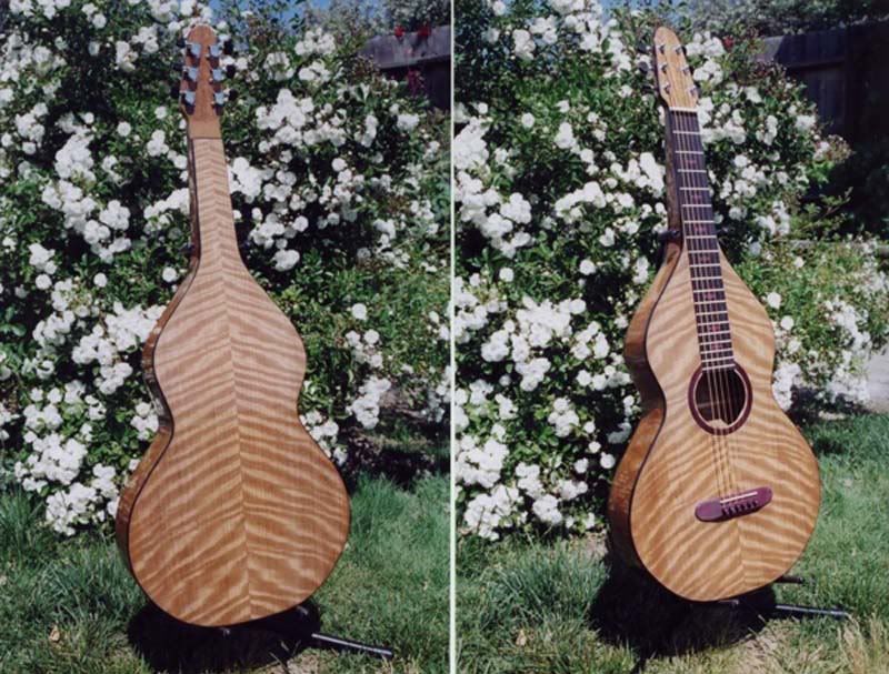

Well alrighty then. I'll also send some shop photos from another thread here. Aaaalaaannn!

PostPosted: Sun Feb 04, 2007 5:34 am
Cool

Very nice Alan! How does she sound?
