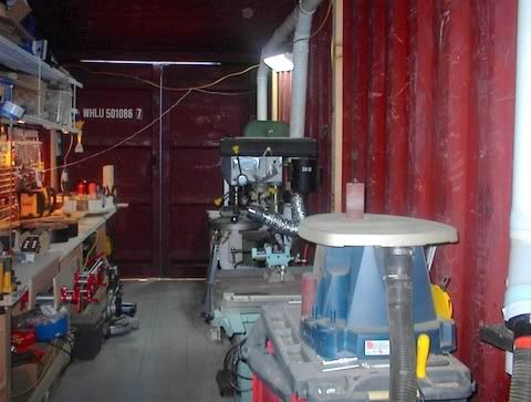

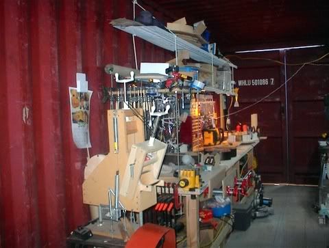

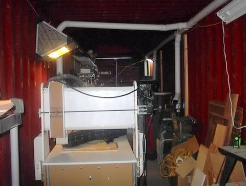

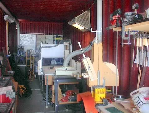

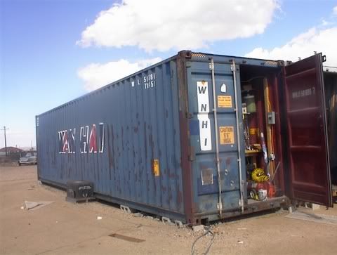

Here is my new Hi-desert Shop in a box.
My shop is contained within a 40' hi-cube shipping container. The container cost $2400.00 and it's a nice space larger than my old garage. I still need to insulate and sheetrock it but I need to try to save up the money first. Let me know what you think.
Take care,
ED.

I'll bet it gets pretty hot in there?
PostPosted: Sun Feb 11, 2007 2:20 pm
Ed, I highly recommend throwing so sort of roof over that, even if its one of those portable garages. As you already know, shade is your friend. Going to throw a swamp cooler on your new shop?
I've told Sweetie that we need to look into one of them when we move. You may have helped me make my case. Thank you.
PostPosted: Sun Feb 11, 2007 2:23 pm
Posts: 299
This past summer when I got the containers it did get hot but I cooled it with a roll around water cooler, it worked well in this dry climate. I will be insulating it before summer arives and it will have an insulated attic area. I found some 2" thick rigid foil backed foam insulation with and R-19 value for $20 a 4X8 sheet. I will also be installing an airconditioner and 2 cieling fans so it should be comfortable all summer long. I think I'll ad Directv to watch well the glue dries.

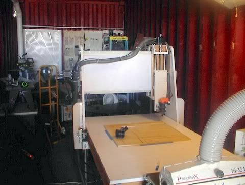

I think it is awesome...and you have made good use of the space...I like that the wood comes off the Performax right onto the table for your CNC router...too cool.
The combination heater/air conditioner that Don mentioned is a great idea. They come in different sizes and are easy to install.

Don I think thats a great idea! I'm sure that will work a lot better than my oil filled heaters. I bought the containers from Golden State containers off the web. If anyone else is interested in doing this, I suggest you get the Hi-Cube containers rather than the standard height. With a Hi-cube you have extra headroom to make a ventilated and insulated attic. I have 2 of these containers side by side, I'm going to open up the last 15' between them and make a 15'X 16' finish area.

Is that CNC machine a "home built"?

Marc, I have 2 windows that I will be putting in on the front plus a door in the center front. Right now I use a hunter fan brand humidifier with a built in humidistat, it works very well. I'll probably use airconditioning in my future closed in office/finishing room and a water cooler in the shop.
Mike, that is a homebuilt CNC Machine, I built it about a year and a half ago and it meets my needs fine.
As far as zoning goes, much depends upon your locality and whether or not it will be permanantly attached to a foundation and utilities. My unit is considered temporary because it's not on a foundation and I have it plugged into an RV hookup that I had to get permits for. I run water for the sink via a waterhose connection just like those used on an RV.

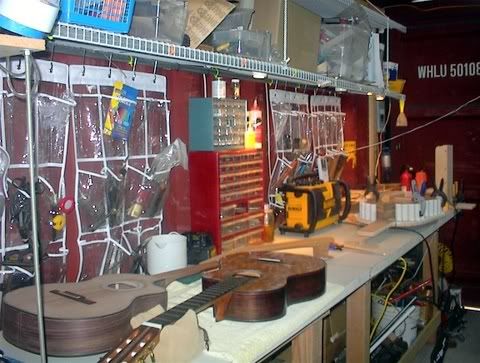

Ed, that’s pretty cool! I really like your use of shoe holders as wall storage. You can see what you have at any time. I would also recommend some sort of covering over the roof. Like the carport style mentioned before. In the summer this would take quite a lot of the heat off the roof of the container. In the winter you could remove it and give yourself a little more direct sunlight. There is someone near me who is building a two story house out of containers. I’m waiting to see how it will turn out.

Philip I'm planning on covering the roof with that elastomeric roof coating. I'm also thinking about putting these containers on a permanent foundation and building a 40'X 16' deck on top so we can sleep under the stars in the summer. The local planning department said they would not have a problem with it as long as I get an engineer to sign off on my plans. They said there have been other shipping container projects in the area that have worked out very well.
