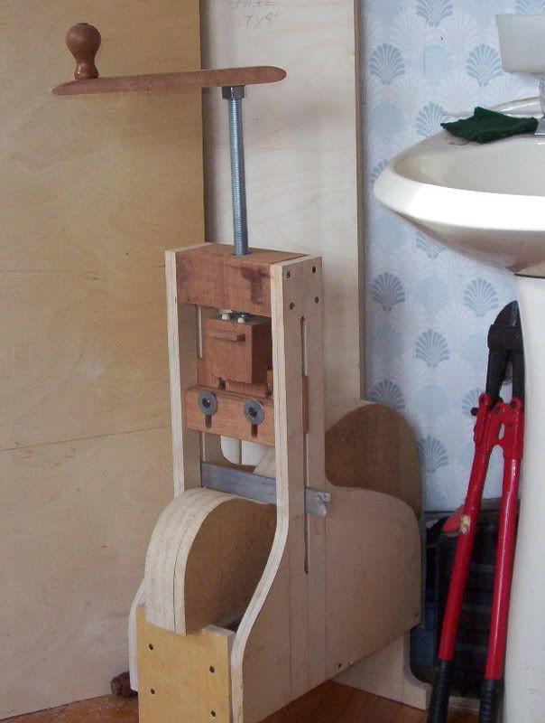

Anyway, I thought Id throw a couple pics out there as Im constructing it - someone was asking about the press mechanism
{you can buy at LMI I think?}-
this was constructed with materials from my hopelessly ill equiped local hardware store, so it can be done.
I still have to make a trip to Slegg Lumber for the springs, this machine isnt perfect, but will do the job.

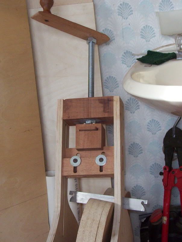

despite the embarrasing chipout, this shows how I used regular hardware parts for the press mechanism,
As I said somebody was asking about this the other day.
I drilled a 3/4" hole through the head block, then a 1-1/4" hole about 3" up into the bottom to accomodate the bolt which was epoxied in.{messy ugly - practical cheap effective}
I drew in pencil roughly how far it goes up in

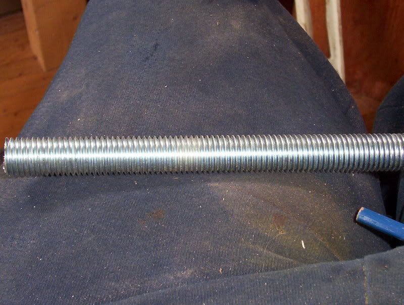

just regular 3/4" threaded rod.
The handle was drilled out at just less that the 3/4" and the wood was carefully threaded onto the rod, then the bolt was snugged up underneath, once theres a dowel plug on top
Bob's your uncle - works like a charm - as you can see that mahogany I bought at $1 a pound is coming in pretty handy!

Oh yeah the waist block portion of the bender was inspired by Shanes mechanism
the threads were ground off at the bottom {3" or so}
and then a recess was created further into the rod, at which point I just made a locking wedge to fit in the slot
and then the wedge pins closed in place with 2 pins on the top of the block.

Nice jig man. Great job. Hey, dope question of the week, but what's the metal bar under the press for? I've been bending sides with my fox bender, but I don't use the metal bar. How 'bout a bit of education for me Charlie?
Bill

Bill, that aluminum slat is the bar that will eventually spring load to the top of the bender,
it holds the steel slats{containing the sides and bender} up tight to the waist block as it is bent,
{keeping the waist area centered - Im assuming - is the reasoning for this}
a routed slot in the actual cross section of the waist of the mold {not finished yet} accepts it, when it is depressed to the full depth of the bend.
Shane - YES, I eventually thought of that, although, many "yes.... perhaps I should" moments have dawned on me throughout my gearing up process!

Oh and PS - the only reason the front foot plate is standing proud in the pictures is because I hadnt cut the through dados into them at the time,{the reason there arent any screws in the side in that area}
