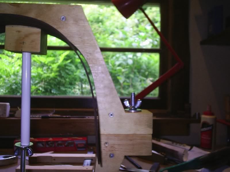

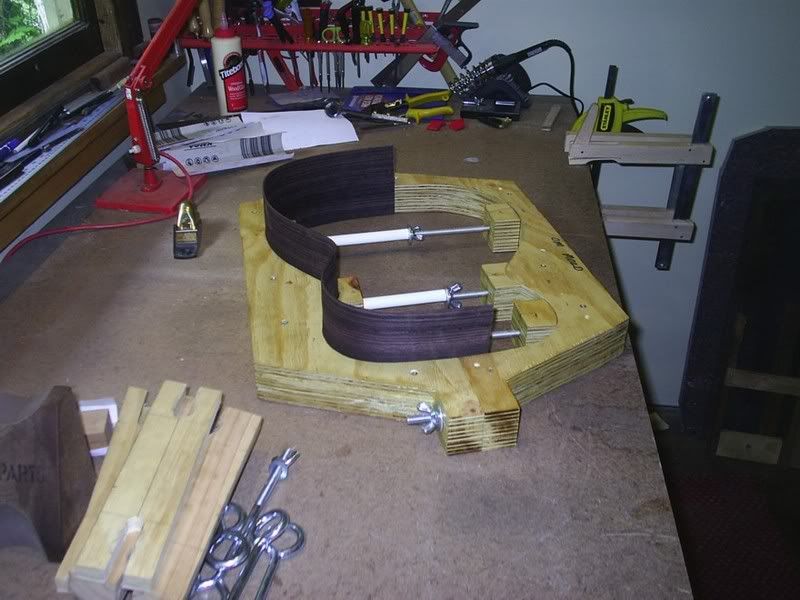

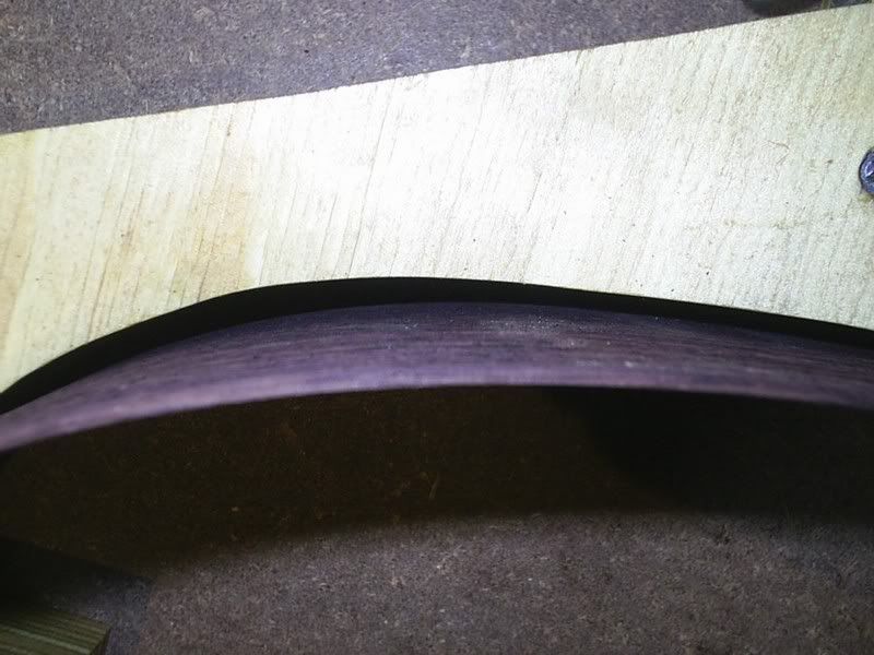

Although this went fairly well apart from a bit of cupping in the lower bout I found a fair amount of springback....to the point of their being large gaps between the side and my mold especially at the bottom and top bouts with the spreaders in....as can be seen in the photos..I'm a bit hessitant to just try and clamp it to mold in these areas for fear of breaking the side.
i was using a blanket and found a lot of resistance to getting it into the bend ....the waist went to the form fairly easy but the top bout i had to put a lot of weight behind it to get it into position...which was fairly stressful....and seemed to take a lot longer than what i've read about blankets..I thinned the side out to around .085"-.090" ...
I'm just wondering what people do to get their sides snug against their mold once they've taken it off the bending form?
are my sides still to thick if they offer to much resistance when bending?
and is the cupping because of to much water? I sprayed the side to the point of it dripping wet and waited till it stopped dripping before wrapped in alfoil.
overall I'm very happy with the first attempt....just wondering what i can do to minimise springback and get it snug against the form.
cheers and thanks for any advice

You want the side to fit into the mold as good as possible. While it is easy
to press the side to shape and glue the blocks in that creates internal stress.
I think the issue is either your mold did not match up just right with your
form, or the wood was not cooked hot enough to set the bend. Never the
less what you have WILL work. Nice job for your first time bending.

oh I just also realized where the springback is..I always offset the butt end of
the guitar way more than the rest. the butt end tapers in on my molds
about a half inch as springback is the worst in that area.

it sounds like a combination of too little heat and not enough over bend at the lower extremity of the bout.
too little heat because eir is an easy wood to bend and your finding the need to use a lot of force is totally untypical.
you really need to have some other method of heat control than simply turning off and on. a heavy duty dimmer, a router speed controller or a variac will all work well. the problem is a heating blanket will readily get too hot and scorch wood. you need to be able to get it to bending temp and hold it there for a while.
as others have said, the mold should over bend the lower 1/3 or so of the bout and 13mm/1/2" is about right.
