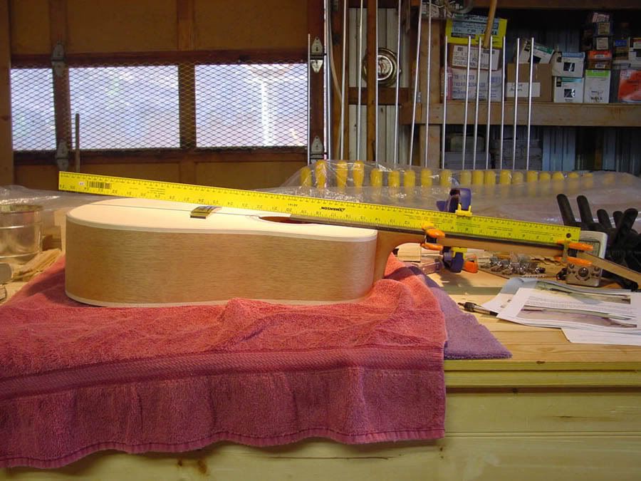

The following pics are for the most part self explanatory.
But, do show in a bit more detail of my situation.
I’m pretty sure of some of what I need to do, but, not all.
So if anyone feels up to it, let me know what you think.
The first pic is just an overall view.

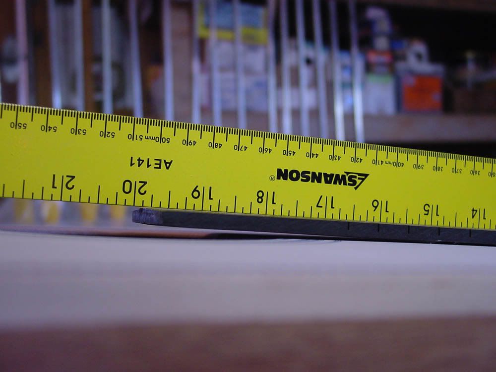

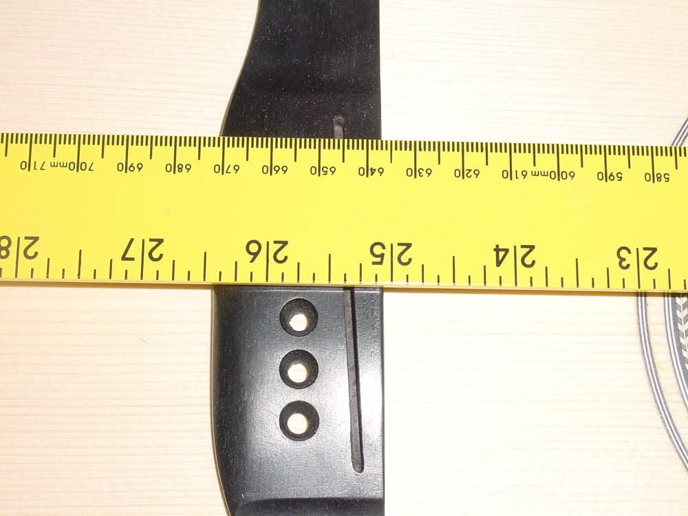

Checking the Bridge Set up

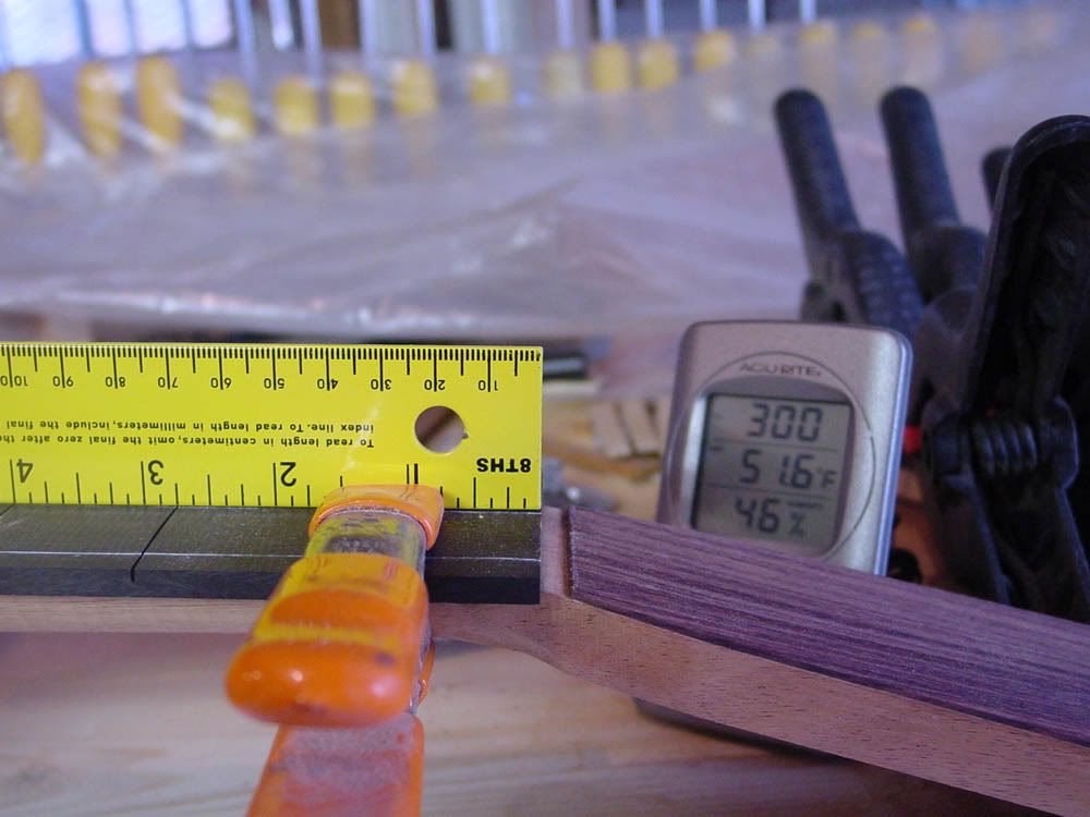

12th Fret Check
The gap at the bridge is almost exactly 5/32"

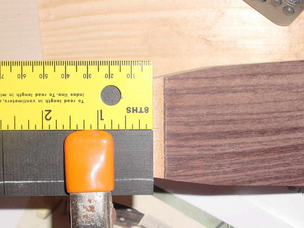

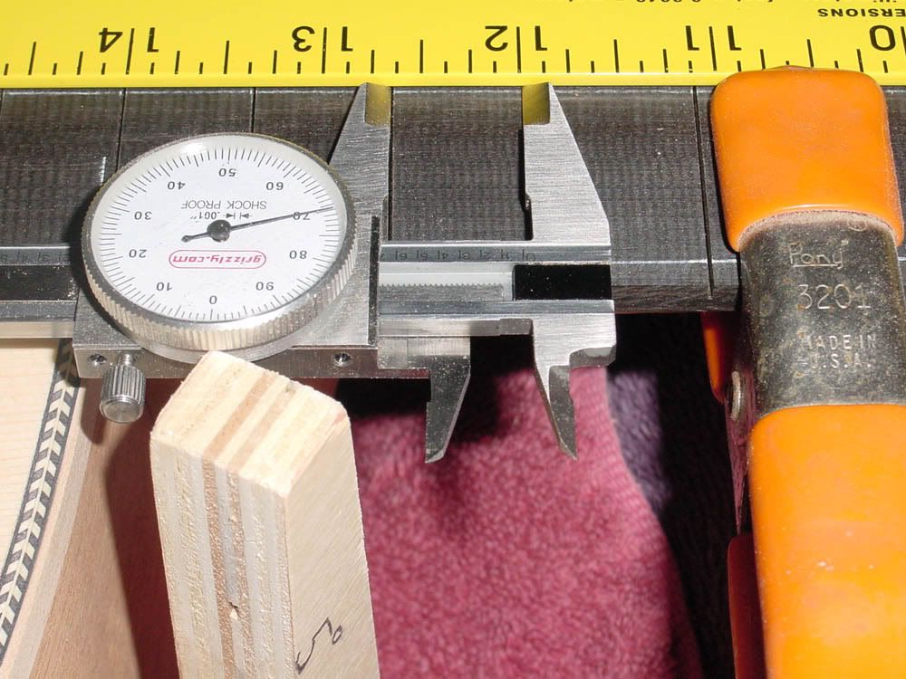

Gap under fretboard is approx. .065" There is also a gap under the fretboard where
neck meets body of approx. .030"
I should note that the crown height of the fret wire I’m using is .050"

It looks to me as though you might have just a bit too much neck angle. The end of your fretboard should touching the top.
I would recheck that and see what you come up with. I had a similar situation like that recently myself.
Don`t take my word for it though. The experts will be along shortly.

Good pics, Robert...they really show the issue. Looks like you need to remove stock from the top of the heel. Are you familiar with the sandpaper flossing method? The angle will shallow out and the FB extension will lay flat. Keep checking the projection occasionally to see how it's changing.
PostPosted: Thu Feb 15, 2007 11:37 am
The way I had it explained to me was like this (gee, I hope I'm remembering this correctly): The straight edge, laid down the bare neck (no fretboard) should be approximately 1/16 - 3/32 off the top where the front edge of the bridge would lay.
Everything else is just a math formula from there...depending on the thickness of your fretboard, height of the frets, desire for the saddle height, etc.
BUT, like was said earlier, smart people will be along any second to completely disagree with what I just said.

My setup differs slightly from the way Hesh does his. I like to be able to
lay a straightedge on top of the frets and have it fall right on top of the
front edge of my bridge (which is just shy of 3/8" tall). If anything, it is
better that the neck angle be slightly higher than the height of the bridge
that have it be lower.

That's a GREAT pictorial Robert. Like most have said your solution lies in the suggested neck angle change. I just wanted to post a thank you for taking such great pictures and showing the problem so clearly.
What I prefer about your situation is that your upper bout angle looks like its perfect and all you have do is change the neck angle. I had a situation where the upper bout angle was wrong and it took a bit more effort to get that right. Let us know how the solution works.
Larry
