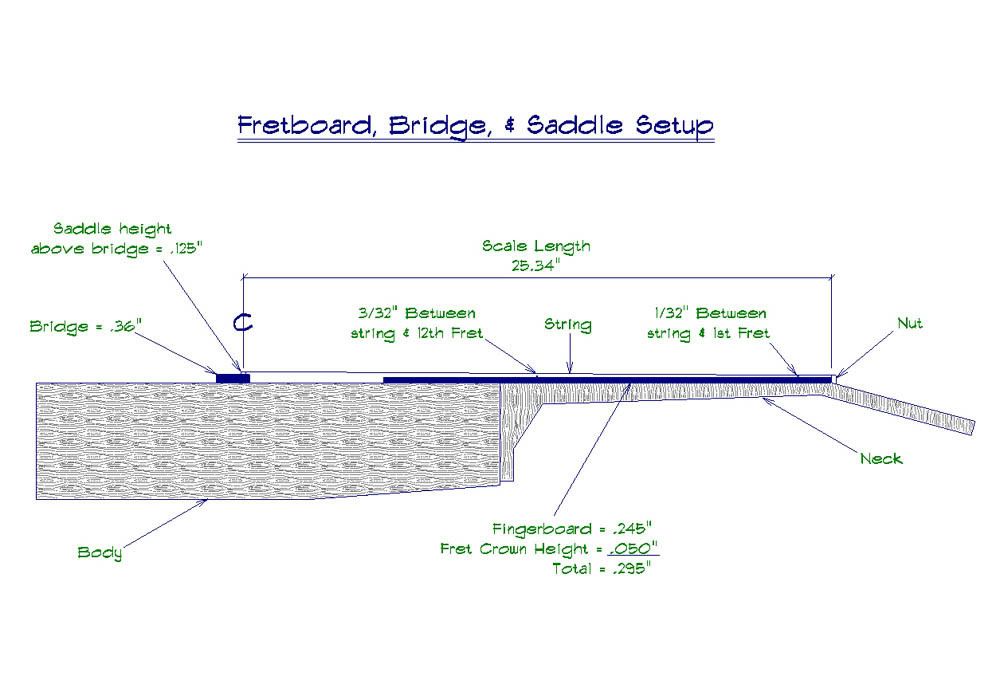

I’ve been doing some math. Then I decided to do a drawing using the measurements that many of
you have discussed in the “Neck & Fretboard thing again” thread, relating to bridge height,
saddle height, neck angle, and so on.
I have an architectural software program that I use to design homes I build. It also can be
used as a very accurate drafting program. In the drawing, the body and neck are only to approximate size.
The Bridge, Saddle, Nut, Fingerboard, and frets are to actual HEIGHTS not widths.
The interesting thing, is when I used the measurements that have been discussed for Bridge and
Saddle height, plus making sure that the nut would allow a 1/32" space between string and first fret.
I get the 3/32" space between the string and the 12th fret that matches what StewMac considers medium action.
You probably can’t see the gap at the first fret, but, it is there. If you could zoom in, you would see it.
So, here it is. Let me know what you think!

There is something you need to be aware of. Scale length is not the string length. If you set up the guitar with the strings the same length as the scale you will be sharp.
   The scale length is static , that is the spacing of the frets on the board. Then we have compensation angle , this allows the working length of the string to vary for the different strings.
   last we have the compensation length. This is what the strings are in the working length.
So on this set up you would want to add .100 for light and .125 to the front of the saddle for mediums. Strings will be longer at work than at rest. If you look at an electric guitar , where each string has its own adjustable bridge you can see where this is in effect. On acoutics you can't have that kind of adjustability so we take as much into the saddle to do compesation on them to get intonation as best as we can.
   Look at any steel string and you can see the angle in effect. Martin uses a 3 degree angle and Gibson uses 4.
   this can get you very close on your intonation. also you want to measure along the strings length not center.
john hall

Robert,
Pretty cool.
Difficult to tell from your drawing but the neck is usually set at a slight angle from the top (pointing down) rather than parallel to the top plane. This brings the string line a little bit closer to the fretboard line. If you factor this in and readjust your first fret height you may get slightly different measurement at the 12th fret.
PostPosted: Tue Feb 20, 2007 10:28 pm
Robert,
Apologies - I see you mention neck angle. What neck angle did you use?

Thanks All for looking, I really do appreciate your input.
First, let me remind everyone, that this is a StewMac Dreadnought Kit.
The fingerboard was already to the thickness noted, slotted, and shaped to, what I would think is
a standard radius. The bridge is completed, along with the angled slot for the saddle.
The bridge will need a slight radius at the underside, but, appears to me, will only lose maybe 1/64" in height.
Also, I noticed that the drawing lost some of its accuracy when I saved as a .jpg file.
If you could see it on my computer, in my software, there would be no doubts to its accuracy.
More over, the drawing is, for the most part, a mathematical test. It is as you all have said, “A Perfect World”
So, given the measurement for saddle height, which has widely been agreed on in past threads,
and string spacing, suggested by the StewMac Manual, combined with the existing measurements
of the bridge, fingerboard, and fret crown height. It seems to me, that the math works, and a
medium action has been achieved.

Dave, to tell the truth, I made no allowance for neck angle in the drawing. The top of the body,
and the top of the neck (Without fretboard) are parallel. But, now that you’ve mentioned it.
Would not even the slightest angle of the neck you are referring to make enormous changes to
bridge height?
Robert

Scale length is along the 1st string, high "e" in most cases. There is comepnsation even at this sting as, as John states, the sting length changes all of the time. As you press the string to fret it, you have stretched the string longer. The compensation issue is used to address this change and is different for each string. Once you do your set up you will see as you intonate each string with your saddle matic. BUT you want to be "close" before you you start as you are limited in adjustment by the angle of your saddle and the width of you saddle.

Nice looking model, great in theory - your guitar neck will however require some relief, ie curvature, likely 4-10 thou at the 6-7 th fret, with the string being held down at the 1st and 14th frets - thus the FB is not flat - it could be setup this way, but more likely than not the low F# and G will buzz when played. Just experience of a few hundred setups, and close to a hundred builds talking ... with lower action, more relief required.
PostPosted: Wed Feb 21, 2007 8:53 am
Also your first fret height of 1/32, thats 31.25 thou, is pretty high - you wouldnt like playing this guitar setup that way for long, especially with medium strings. Shoot for more like 15-20 thou high to low to start, then as the guitar settles in, maybe take it down more. I measured Bob Bennetts older Ryan GC a few years back, it was 11-16 thou, pretty much the limit.
What you will obviously find that is when the first fret number drops, so will the 12th fret number - so to get back to 3/32 action you will need more saddle height.

Well, I think I owe an apology to StewMac. Turns out I should have read the next page.
Don’t I feel a little dumb right now!
The manual states that the final clearance at the first fret should be:
“E (1st), 0.012"; B (2nd), 0.012"; G (3rd), 0.014"; D (4th), 0.014"; A (5th), 0.016"; E (6th), 0.016".
Thank you Tony for pointing this out.
Oh well! Back to the drawing board
