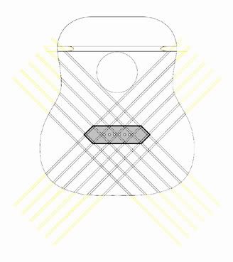

    What I was struck by was the bracing pattern that they call square bracing. It's a crosshatch of small braces around the bridge plate. I was wondering if any of you guy know anything about it.

Very similar to "Lattice" bracing. Fylde also has a similar bracing pattern
but with less cross-bracing.

It's just your standard "sextuple-X" pattern.

     The bracing looks thin and low making up for that with numbers. They also are without intersection stiffeners, might be a place for improvement. My buddy Bob say's he's going to buy one so he'll probably let me try it out!

that is sort of similar to the Somogyi bracing, except Ervin's is an x-brace
with the cross hatches further spaced out and overlap onto the bridge plate.
Ervin's fingerbraces are splayed out as well. And just from looking at an old
picture that was posted in Ervin's discussion in the old voicing forum Ervin's
x-brace seems to be a different angle than "norm" as well..possibly a little
tighter than normal. Seems like an interesting approach. Not one that I'm
really interested in at this time, but interesting combo of classical guitar
meets steel string guitar, and Ervin's guitars sound great so it's gotta work.

Apparently not all Furch models have this multi-X bracing- I noticed on the website 'factory tour' slide show that there were some standard Martin lookalike tops.
